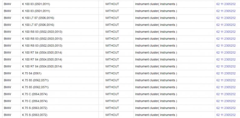

Post by: johnny on August 06, 2019, 09:41:36 AM
some k75s k100s k1100 use different footrest brackets...
to know for sure you gotta put your vin in here... find the oe part number... use the etk to see what motos it fitts... anything less will be an expensive education as you donts knows what you had and you dont knows what you got... assume nothing... intel is powerful... (http://www.motobrick.com/index.php/topic,9770.0.html)
furthermore... poast up photos of your entire moto so we can see whats you gotts there...
example... tommt wants a 62112305252...use this method and you know everything about what fitts what...
this is what the etk says... wont fit every k75 k100 and no k1100...
* etk.png (54.14 kB . 768x379 - viewed 1027 times)

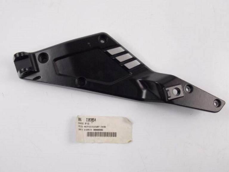

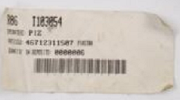

Post by: johnny on August 06, 2019, 08:09:32 PM
* 46712311507.jpg (22.84 kB . 768x576 - viewed 992 times)
* sticker.png (93.05 kB . 365x204 - viewed 1048 times)
