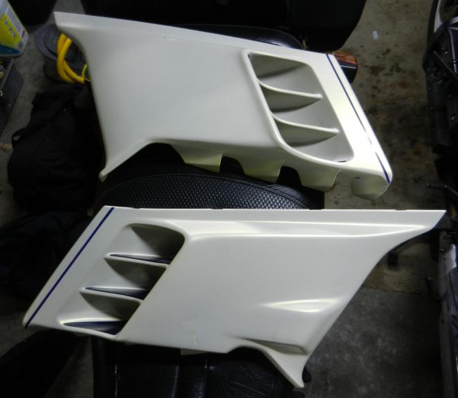

Actually, the photos above were taken by the previous owner in his garage.  Here's a few more taken when i got her home.  The dirt doesn't really show in the photos.  The tank is probably in the worst shape of the painted parts.  It is covered with paint spatters and the some sort of heavy grease.  The inside has a lot of varnish and there is a lot of crap from the vibration damper all over the interior.

I hate having dirty parts laying around, so over the weekend I took some of the panels to the laundry tubs with my trusty bottle of S-100 cleaner.  Spray, rub with a sponge, rinse, repeat.  I am surprised at how good the paint looks.  There are a few minor dings, but nothing that really needs repair.  Mostly just signs of use.

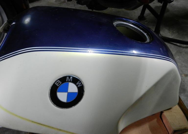

The spatter on the tank really bothered me along with the mess inside.  I decided to to do a soak with Dawn dish detergent of the interior to prep for Martin's vinegar soak.  With the tank sitting in the laundry tub full of soapy water over night the spatter came off with a gentle rub.
* DSCN3572.JPG (33.63 kB . 768x549 - viewed 5255 times)
Cleaning the outside of the tank revealed that there is a minor dent in the side, no big deal, and that side of the tank has been repainted.  Not a bad job, but whoever did it did not use the pearl silver the rest of the bike is painted with, but used what looks like refrigerator white.  Fortunately, I have enough paint left over from another bike to repaint that side of the tank.
Most of the interior's varnish pretty much came off with a Scotchbrite pad after soaking overnight with the Dawn detergent.  There is still a lot of black goo from the damper around the inside and especially caked up on the fuel level sender.  I hope I can clean it off without damaging the windings.

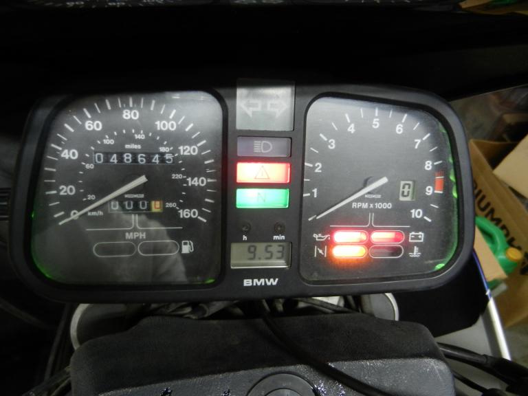

With the ability to turn on the ignition, I connected my jump box to the battery wires and set the clock in the instrument cluster.  Holding my breath and watching closely for smoke, I turned the key and to my amazement the headlight and tail light came on!  The gear shift indicator works and the idiot lights work in the cluster( a few of the illuminating bulbs are out).  Brake light works, high and low beams, and the parking lights. Turn signals, horn and hazard flashers don't work, but looking at the relay box it appears some relays and the bulb monitor unit may be missing.  I hit the starter button briefly, and the engine turns over!  The harness looks to be in pretty good shape, better than I've seen on a previous bike, so I don't think it will need much to work properly.
* DSCN3568.JPG (53.67 kB . 768x576 - viewed 5310 times)
* DSCN3567.JPG (44.1 kB . 768x576 - viewed 5205 times)
* DSCN3569.JPG (44.46 kB . 636x576 - viewed 5286 times)

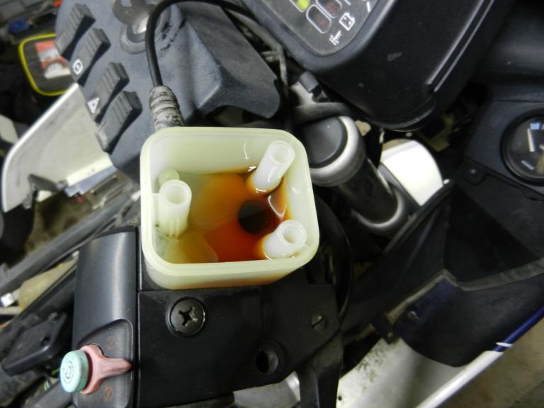

Popped the cover on the front brake master cylinder and the fluid looks like maple syrup.  I'm gonna do a flush and bleed before I strip the bike down to get that crap out of the parts.

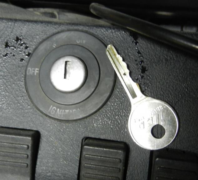

Since the bike was so dirty, I thought it would be a good idea to clean the ignition switch while I had things apart.  Turned out to be a good idea as there was a bunch of waxy looking crap all over the place around the contacts.

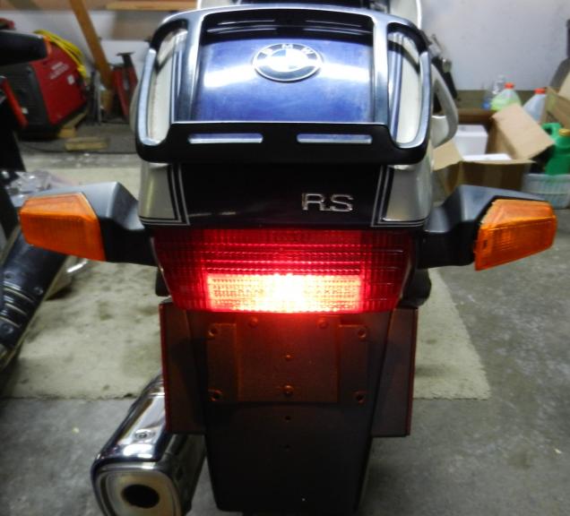

I did find some chafed wires in the taillight wiring harness, but I had a spare and replaced it.  The wiring is now in perfect shape, as far as I can see.  Even the connectors look clean, but I'm still shooting them all with Deoxit and coating them with a film of dielectric grease and putting Vaseline on the connector shells to make them easier to separate

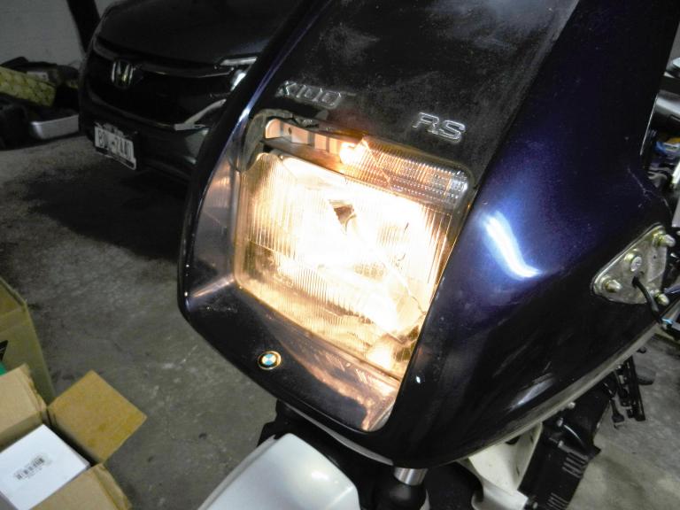

With the fairing removed I did a good cleaning with S-100 and replaced the broken headlight with a spare I had.  Outside of a few stone chips and some crazing around a mirror mount the paint is in pretty good shape.  Wow!  The more I work on this bike the more it looks like it doesn't need much work.

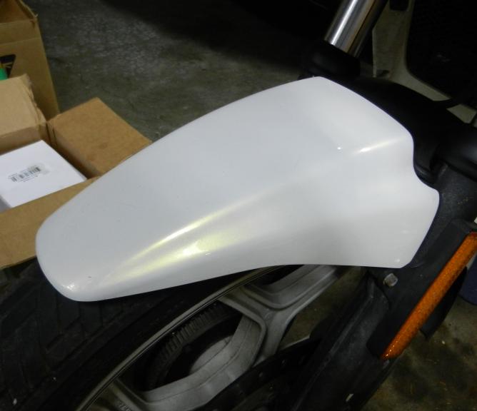

Past week or so I've been doing paint prep.  Yesterday I shot the Bermuda Blue, and today I couldn't put it off any longer so I shot the three part Pearlmutt.
Am holding my breath that I didn't feck up the gold effect too much.  Last thing left is pinstriping the front mudguard before I buff them out.

Finished buffing out the parts I painted.  Once the clear went on them it became obvious that I didn't have the gun set up properly for the mid-coat of the Pearlmutt.  It has a spatter effect that didn't show up when I was laying it down.  I also didn't put down enough of the mid coat to give the proper gold tint to the paint.  It's close, close enough that I'm not repainting.  I can see it, but hope that at 20 feet a stranger won't.
The parts buffed out pretty nice, and I have put them on the bike.

Update: Last night I painted the pearlmutt on the main fairing and today I did the final assembly of the bike.  As luck would have it the turn signal flasher developed a problem.  Fortunately, I had a spare, and was able to get the signals working.  Now I just need to fix the bad flasher.
Pearlmutt is the worst color I've ever painted.  It's almost impossible to tell if you have the right amount of the midcoat.  As luck would have it, it was not heavy enough to get the right amount of gold tint when the clear was applied.  it looks like I have some more painting next year.  I'm hoping that I can just put more over the clear without having to strip it all down and start over.
Al in all, the bike doesn't look too bad.  Everything works now, including the ABS, and the engine runs nice and smooth.  Looking forward to a maiden ride to run it through the gears and see how the suspension works.  Maybe Friday when the rain stops.
