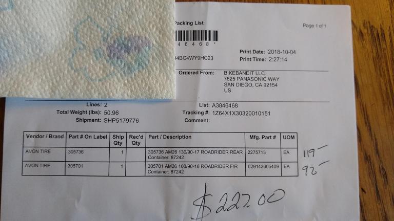

Post by: SDCR john on August 01, 2019, 08:58:15 PM
Scott,
Thanks for the tip. I looked online, but could not find the 100x90-18 front size. Did you buy yours recently?
I'm very happy with my Avon Roadriders, they are the right type tire and size for these motos and reasonably priced.  Might be worth a look, I've always found the Metzlers to be a bit twitchy.  I suppose it's subjective, but I've owned many motorcycles and am really and happy with these.  Another tire i liked on my r100r was a Pilot Active, I think by Michelin.  Happy searching, chunk.
Title: Re: Radial Tires on a 94 K75 S
Post by: Scott on August 01, 2019, 09:37:42 PM
Yea, not too long ago, I might have bought the set here or bike bandit.  I'll look for a receipt and post if i find more.  scott.
https://www.jpcycles.com/product/210-171/avon-am26-roadrider-100-90-18-front-rear-tire?mrkgadid=3300286578&rkg_id=0&utm_source=google&utm_medium=cpc&utm_campaign=Google+Shopping++Manufacturer+Intent+-+Tires&product_id=210-171&utm_content=pla&adpos=1o1&creative=278823731742&device=c&matchtype=&network=g&gclid=CjwKCAjwm4rqBRBUEiwAwaWjjKlowkFduX41EHJeipExc3rlYVYTkTPABGq4Dqm1bY2GZ_9AP0AzzhoCIA4QAvD_BwE
edit to add:  I found the receipt, i got them from Bike Bandit.  see attached.
