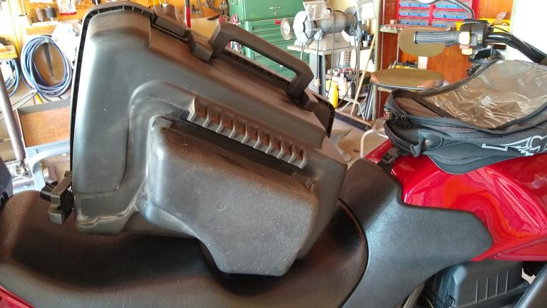

My 1992 K75 came with two BMW side cases.  All the locks work but I didn't try to mount them until I took possession of the motorcycle.  That's when I discovered they don't fit.
The problem is caused by the rear rack -- it narrows the space at the end where the cases hook to the mounting bracket.  I've posted a photo below. To get them to mount I'll need to grind off two of the plastic hooks on the back of the cases.  Then they'll mount fine.
My question -- will the loss of two mounting hooks on the cases create an unstable or bad situation?  Doesn't seem like it would but before I start grinding I was wondering if anyone has experience or thoughts on this.

The cases are in a friend's garage right now but they are the standard BMW black plastic cases.  The rear rack mounting is the problem though -- they interfere with the mounting because they restrict access to the end of the bracket -- the rear rack metal makes the opening too narrow for the mounting system on the back of the cases.  Take the rear rack off and they mount fine.
I'll take some more pictures later.

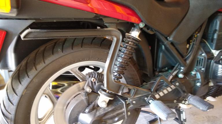

Post by: ScooterNSticks on July 28, 2019, 06:59:17 PM
Here is the side rail and a shot showing the narrowing between the rail and the rear rack mount.  I'll have to get shots of the cases later.
Title: Re: K75 sidecase modifications
Post by: Laitch on July 28, 2019, 07:14:40 PM
Your photos make clear the cause of obstruction. I don't need more photos of the cases. If that were a Reynolds rack designed for the K75, there would be sufficient room for the case mounts to slip onto the top of the z-rack It might be that your case mounting technique needs refinement. Post some photos of the rear rack itself and look for identification words or numbers stamped upon it. The profile shot of your moto in the cornfield isn't quite enough to identify it completely.

I've examined the rear rack and can find no brand, writing or inscriptions on it.  It is definitely the culprit.  It's sturdy but obviously not a BMW product.
If it's not going to work with the side cases, where might I find a rear rack that will?
Here's the images of the rear rack and cases.
Thanks for your help!

Here's a 240. Note the tabs at the arrows. Does yours have them?

Post by: ScooterNSticks on July 28, 2019, 08:38:59 PM
Yes, there is a tab on each side where an attachment is made to the Z rack.
Here's the 240 marking.

Post by: johnny on July 28, 2019, 08:56:00 PM
oe baggs are hard to slide on for the novice bricker... and the 240 reynolds rack can complicate that...
with z bar lock open you have to hold the bottom of the bagg with both hands... start as far forward as possible... commence to twerking until it slides in there then slide it back and close the z bar lock...
if it wont go you may need to remove the reynolds rack and reinstall it all square and the like... then your baggs oughtta go on as long as you use the 2 hands twerk method...

I have the same "240" rack on my K75, it is quite fiddly at times to get the sidecase on, and at other times it just falls into place. Haven't figured out the exact alignment approach, and just wiggle it a lot until it drops on the Z rail. I wouldn't cut/grind anything that is designed as load bearing by the uber master's at BMW, those mount fingers serve a purpose.

Exactly the same as mine! In fact, for some reason, the left case just fits right on, but the right case is a real pain to fit or take off!
I find that swearing a lot, as you wiggle it, helps immensely. It’s just another one of those crap bmw ideas that sort of works, when they threw the rest of the bike around the engine. The engines are great, but everything else on them,isn’t!

If you decide to reinstall the Reynolds, I see where my mount is different. Instead of drilling a hole in the Reynolds to use a longer mounting bolt, I zip-tied the Z-rack. Testing was done with 27 pounds of dive weights, driving along backroads and rough graded gravel community parks. No issues, and it adds to the excitement and spirit of adventure vs. highway junk show, while toodling along on the Brick with the bicycle on the rack.

I don't understand why your Z thingie doesn't line up with your Reynolds rack. After work I have to go look at my setup and ponder how this could be.
Could you let me know the findings? I tried using a carriage bolt, and sliding the Z-rack into the "U" bracket space behind the 240 rack's side, but it didn't leave space to wiggle into the bricks frame mount. I half considered just making a short drop shackle to bolt to the 240 and then bolt onto the Z, but it looked wonky in prefab.
