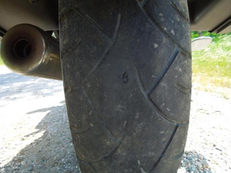

- Start rotating the wheel while dousing it with water. You're looking for air bubbles from the leak.
- Use the headlamp, if you haven’t let the batteries discharge. It will help. When you find one, mark the leak with WiteOut, lipstick, blood spatter or etc.
- Extract whatever is causing the leak. If the leak is out of the tread area, in the sidewall or around the rim, or if the sidewall bead has pulled away from the rim, temporary repair won't be possible.

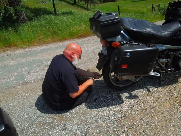

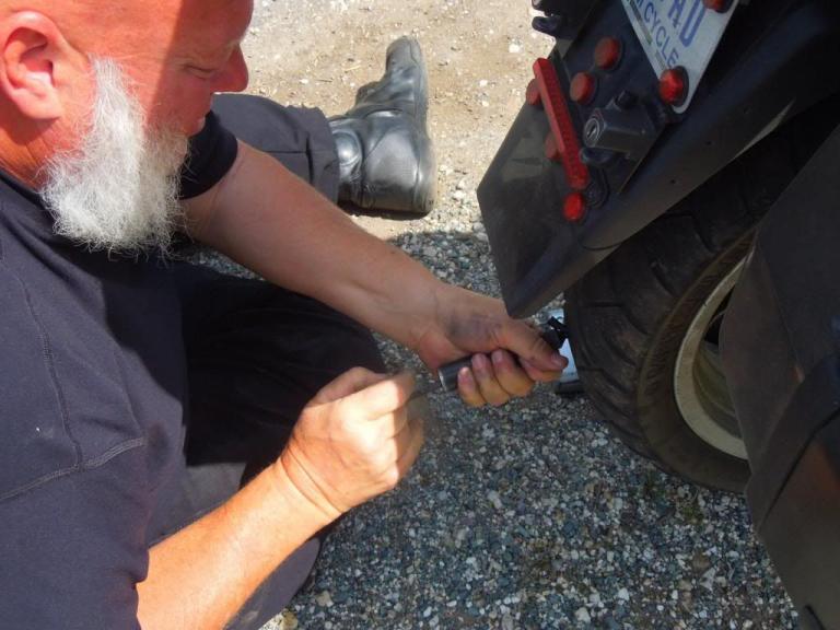

- Take the reamer from the repair kit and ream hell out of the hole until it is round.
- Put glue on the reamer and run it into and out of the hole.
- Put a plugging strip into the insertion tool's slot, center it into the slot then glop glue onto it until it is completely covered.
- Push the glue-soaked plug into the hole about two thirds of its folded length then remove the insertion tool. This will take strong determination. If you can shave your head before you do this, that's likely to help.
- Cut the plug off close to the surface.
- Keep looking for holes and repairing them. You might need to inflate the tire again to help with rotating the wheel if the moto is on the center stand.
- Repair the other leaks then do the final inflation and check for leaks.
