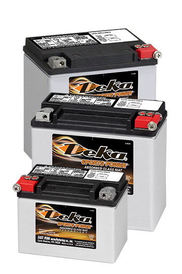

east penn manufacturing (http://www.eastpennmanufacturing.com/applications/power-sports/) makes many batteries marketed under many names...
whats you wants is a etx20l... the 20 pounder etx... all east penn brands use etx20 in their part numbers...
you know you gotts east penn when you gotts the red cap and the screws...
* product-power.jpg (65.71 kB . 360x543 - viewed 493 times)

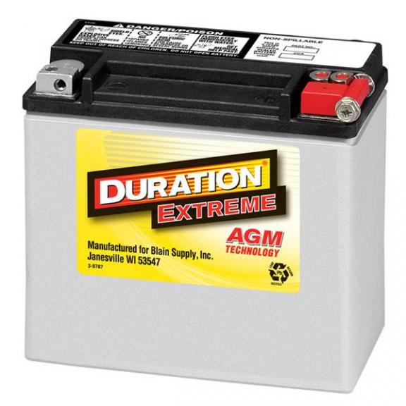

my blaines farm and fleet east penn is called duration extreme... (https://www.farmandfleet.com/products/362985-duration-20lbs-agm-powersport-battery.html)
* duration.jpg (40.16 kB . 576x576 - viewed 560 times)
its a strong runner in its 4th riding season... garaged in unheated garage on a deltran bettery tender jr (http://products.batterytender.com/Chargers/Battery-Tender-Junior-12V-0-75A.html)... -35 peak this past winter...
i run a voltage meter... im 13.8 no catz xlo and 13.7 with catz xlo while riding tached up... will be at 12.8 to 12.6 after sitting for a few days of untendered nesting...
i have now and or have had 4 of these in 4 different motos... all 4 have been 100%... im thinking you should have the same results if you wanna give it a go...

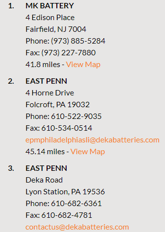

east penn has 3 deka stores a half hour away... (http://www.eastpennmanufacturing.com/contact/where-to-buy/?division=186) note... always measure to make sure its gonna fit before buying...
