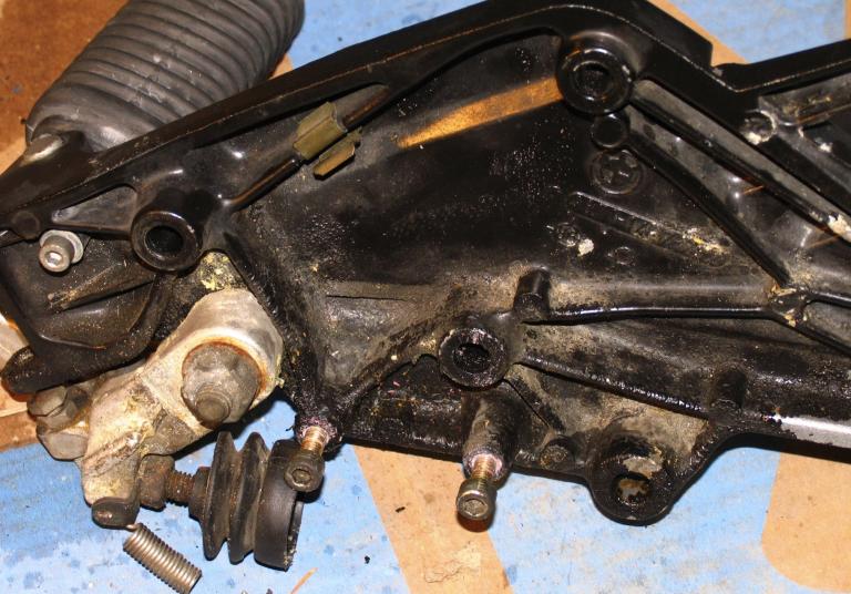

It's been over a week since the first project post. I got the tank off today after taking advice from another post to take the seat off and stradle the bike and pull up. The fuel level sender wire was unplugged and the rear of the tank free from the two rubber gromets (12mm circlips were still on there so took them off). Even after loosening the hose clamps on the fuel lines they were on the tank nipples very snugly and could not be just pulled up from stradling the bike. I ended up grabbing the left side of the tank with my right hand, where the fuel lines come out, and pulled up using my left hand to grab the rubber lines and wiggle while I pulled up with my right hand. Success!
Yes I have the float type fuel level sensor (see photo). As you can see it is toast and used or after market are hard to find so looks like I will spring the $224 from EME or from MAX BMW same price.
The tank was about as dirty and full of rotted rubber vibration foam as others I have seen posted.
I suspended the tank by a wire through the two rings near the front of the tank. I wanted all the crud to fall into the end so I can remove it. I sloshed some gas around in there to wash the particles down and then siphoned the gas off with the siphon tube.
I also plugged the two fuel lines so as not to get any dirt falling into the lines. I did not have golf tees so I used pens that seemed to work well.
Here's a shot of the inside after spending about an hour just trying to get the particles out, using gasoline and rags. I scoured this one area with a 3M Scotchbright pad. After the tank dries out I am planning on using the two bottles of white vinegar I saw posted here. Will inform of the results with that.

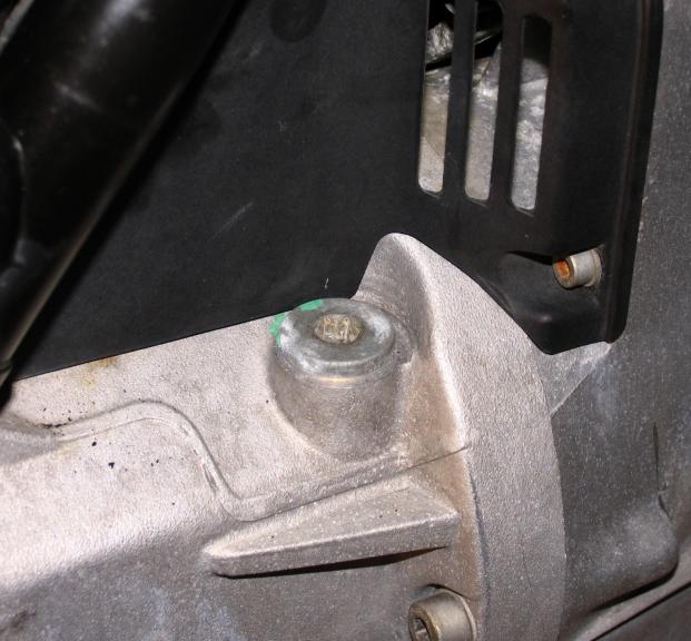

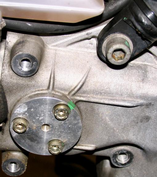

I drained the radiator yesterday but I couldn't find the drain plug in the water/oil pump (see Haines photo). I got under the bike with a light and for the life of me did not see that plug. Could there have been different style pumps without the plug? I ended up taking the hose off the water pump to drain it.
Haines manual shot of drain plug.
Title: Re: Awakening 1987 K100RS from 10 year slumber.
Post by: rbm on June 30, 2019, 10:21:10 AM
There could be a temperature sensor installed on your pump in that hole instead of the plug shown in that photo.  That sensor would have been used by the water temperature gauge as part of the auxillary instrument package (if your bike originally had that option).  But all oil-water pumps for the classic K's were the same.  In that photo, you can just catch a glimpse of the rubber boot over the oil pressure switch that goes to the OEM gauge cluster.
Post by: SpecialK on June 30, 2019, 01:40:30 PM
Thanks Robert, they said I would get a lot of knowledgeable replies on Motobrick. I did see a rubber boot where the plug should be and there is a sensor in there. I also have a temperature guage on the fairing

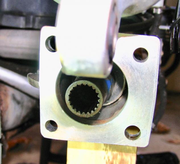

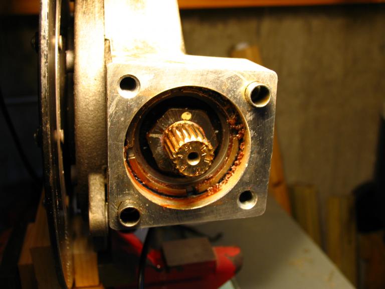

Post by: SpecialK on June 30, 2019, 01:49:48 PM

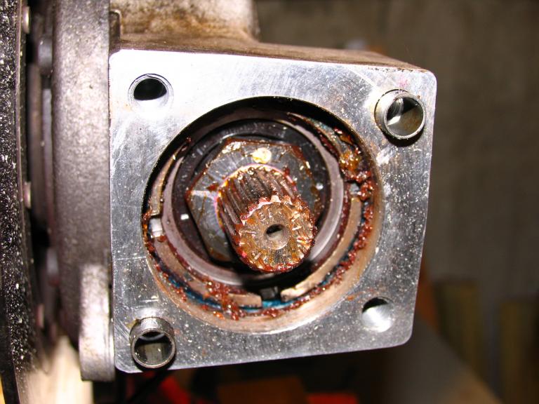

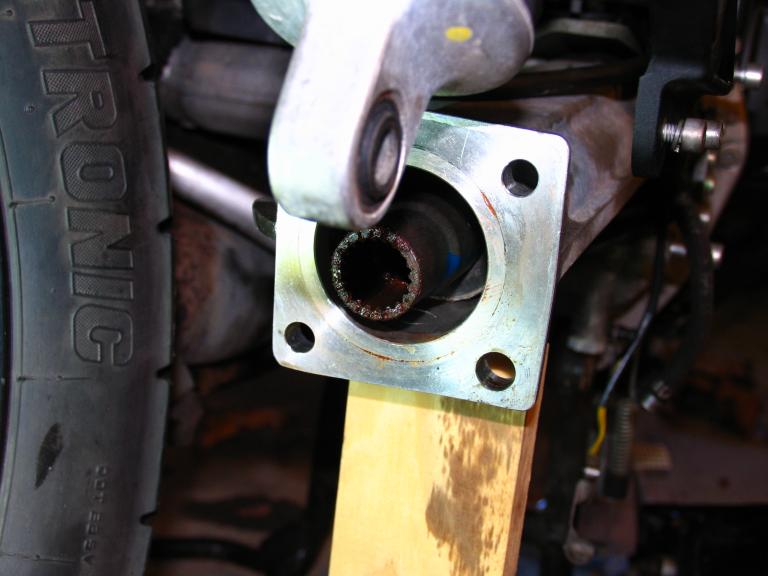

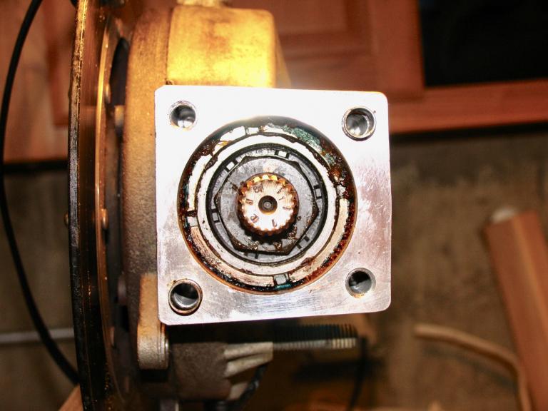

Checking and lubing the FD spline is a piece of cake, and takes an hour of leisure wrenching. If nothing else, it'll give you peace of mind and a starting point for maintenance.
I would plan on doing this. I have some invoices from work done back in 1991 that shows the spline servicing was done at 7,000 miles and the bike now has about 15,000. Do you think it would still be in good shape after 8,000 miles? Thanks
Post by: natalena on June 30, 2019, 03:16:39 PM
Not due to mileage, but rather extended time, the spline lube could very well be dried out and the consistency of stale Pop Tart filling. I would guess blueberry. Anyhoo, removing the rear wheel, supporting the drive so it doesn't sag down and ruin the rubber bellow (I just use a jack stand and piece of wood), and removing the 4 hex bolts is one of the easier things to do on the brick. Hint: make sure the wheel spacer is in place when bolting the rim back on. Cheers!
afterthought ... you could check/clean the speedo pick-up on the FD at the same time.
Post by: Laitch on June 30, 2019, 03:26:15 PM
To followup natalena's observations, changes to improve durability of the splines occurred around 1989–1990. These changes helped extend service intervals out to approximately 40K miles. Your model year indicates annual lubrication for the transmission input splines on the BMW service interval form (http://www.verrill.com/moto/k75sheet.pdf) but I doubt many riders would consider performing the procedure that often.  A machine that has only been ridden a couple of thousand miles might need relubing. A machine that has been mindfully ridden might not show symptoms for tens of thousands of miles. A machine that is ridden hard over rough pavement and gravel might need looking at sooner.
The underlying concern is whether the factory techs actually did the procedure correctly. My inclination would be to lube them now then check again in 10K–20K miles depending upon how many miles are ridden annually, how hard the machine is ridden and how well it is downshifting.
Post by: Laitch on June 30, 2019, 03:36:34 PM
I think many here lubricate final drive/driveshaft splines at every tire change. That interval would fall somewhere between 5K to 11K miles.
Post by: SpecialK on June 30, 2019, 05:04:59 PM
Thanks guys for the spline info. Seems that's one of the most common issues to look after on these bikes. Will definitely check the slines when the time comes.
Post by: The Mighty Gryphon on June 30, 2019, 08:37:44 PM
I do mine as part of the end of season maintenance ritual.  I don't pay any attention to miles although I do record the odometer reading, and last year started taking photos of the splines to document their condition as part of the maintenance record.  My bikes annually get about 4-5,000 miles on the RS, and about 7-8,000 on the RT.
The RT now has a bit over 92,000 milles and the splines are just beginning to show a hint of wear.  I would expect them to get me to at least 150,000 miles before I'll need a new driveshaft or final drive.
Post by: SpecialK on July 01, 2019, 08:29:36 AM
They look to be in decent condition. Am curious to see what mine look like when I get in there. Have no idea if the bike was driven hard on rough roads or pampered. I'm hoping for the latter :2thumbup:
Post by: natalena on July 01, 2019, 09:21:05 AM
The fun thing about checking splines, is it's like opening a Kinder Egg. Sometimes it's a so-so toy, and sometimes it's awesome and worth dancing around the brick like a savage.

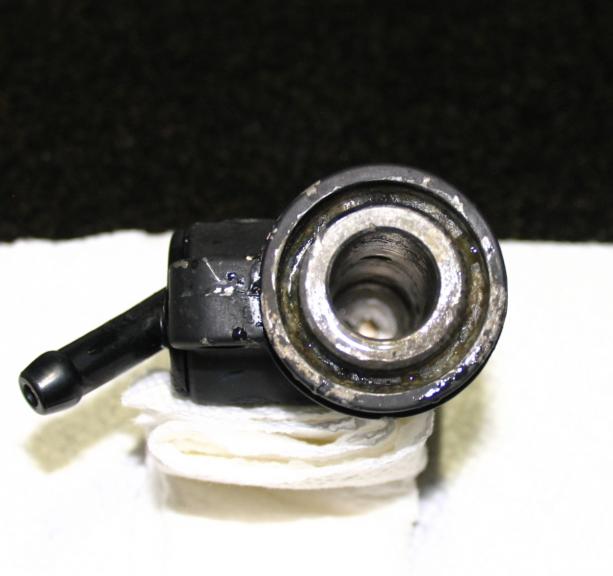

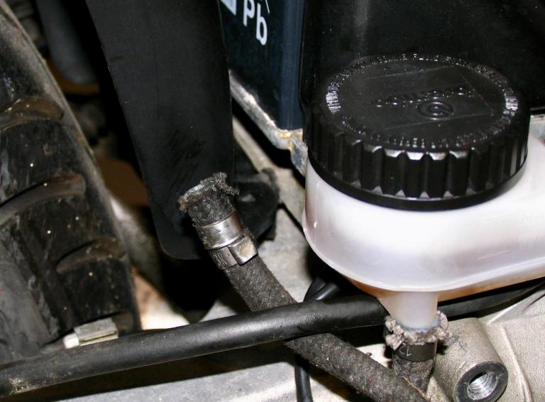

Not much work today except took the temperature sensor out of the water pump and drained the rest of the fluid. I saw a guy on youtube pull the wire clip off and use a 14mm socket so that's what I did. See photo.
Here is another photo of a rubber, looks like crancase vent tube, in front of the air filter housing, that has a hex scew in it. Is the tube supposed to be open? Why would the hex screw be in there?
Thanks.
Post by: natalena on July 01, 2019, 08:34:13 PM
That hex looks like it's plugging the tank vent tube that leads to the crankcase. Nearly everyone has that tube crimped, plugged or removed and the case hole plugged. No worries. The origin of the tube is the two nipples on the bottom of the gas tank.
Post by: SpecialK on July 01, 2019, 08:40:26 PM
Yes I saw those nipples. don't they just rest inside that little plastic cup under the tank?
Post by: The Mighty Gryphon on July 01, 2019, 09:55:48 PM
When you put the temperature sender back into the water pump be careful to only get it a bit more than snug.  The sender has a thin wall at the top of the threads, and if you get carried away with torque it will break off.
Post by: Laitch on July 01, 2019, 11:09:34 PM
Once upon a time, that vent tube was also attached to one of the two ports that now empty into the cup attached to the frame. There was a one-way valve in the middle of it. The tube's purpose was to meet California emission standards by venting fumes from the tank into the crankcase. It was an imperfect idea so the remedy was to remove the hose from the fuel tank then either plug the crankcase port or plug the hose, as natalena indicated. Somebody screwed your hose to plug it.  If the crankcase port were not plugged, the engine would likely run rough or stall.
After decoupling that from the crankcase, the tank vent port—and the fuel cap water drain port next to it—either had hoses attached to them that dumped behind the right foot peg plate, or the ports dumped into a cup attached to the frame like yours do. The cup should have a hose attached to the underside of it that dumps downward behind the right foot peg plate.

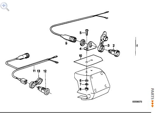

Also, in the relay box under the tank, there is a white and a black pin connector that are not connected to anything (see photo). Where do these go? Accessories?
They don't go anywhere. They're happy where they are. The largeer is an accessory plug that has both switched and unswitched power; the smaller can also be use for appropriate accessories or an alarm.

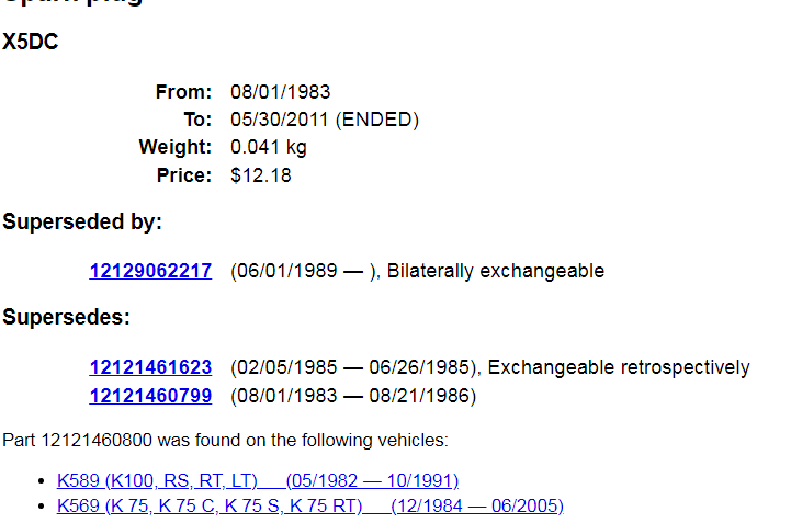

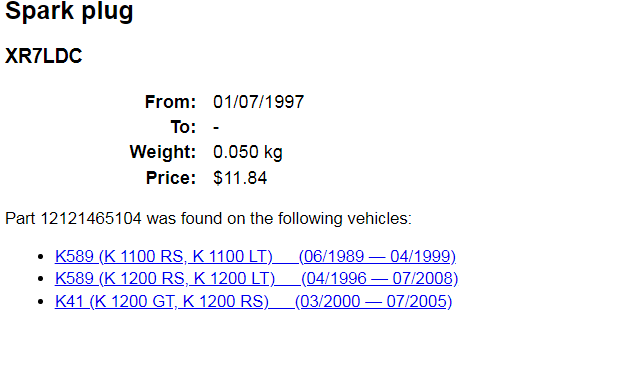

Post by: johnny on July 05, 2019, 12:32:27 PM
bosche xr7ldc... (https://www.euromotoelectrics.com/v/vspfiles/assets/images/superplus_designationcodes_10.pdf) 60+ thou miles and still look like the day they went in there...
* boche.jpg (31.59 kB . 524x576 - viewed 1854 times)
its like each cylinder is double plugged by oak...  if you needs to hoe shot... these will getts you down the road like a 4 holer...
doo your own doodillergence...
* X5DC.png (20.52 kB . 721x477 - viewed 1929 times)
* xr7ldc.png (13.26 kB . 639x390 - viewed 1920 times)

Post by: SpecialK on July 05, 2019, 01:23:09 PM
Thanks Johnny. Since my bike is the earlier 1987 2 valve K100RS, I went with the non-resistive equivalent to the Bosch X5DC which is the NGK D7EA.

The plugs are the older Bosch X5DC so I am going to try the new NGK D7EA. Will need to get the terminal nuts.

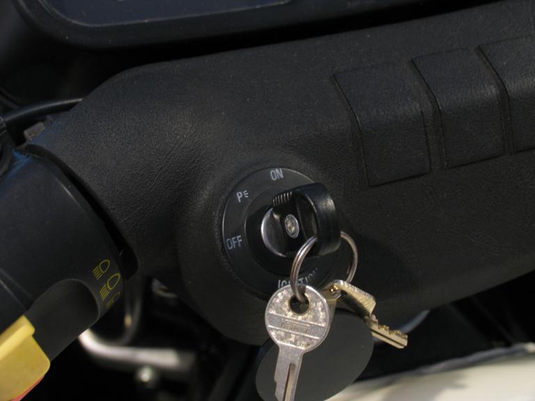

Tried the trick Johnny mentioned in "No Start" #1 rolling the bike in 3rd gear in reverse and popping the clutch for 3x. Also tried jumping it in 3rd gear rolling forward with no luck.
One strange thing I don't know if it has effect on the bike starting is it looks like someone messed with the ignition switch (see photo). The ignition is OFF in the ON position and has to be turned to the 3 O'clock position for ON. Looks like it was put in wrong but it doesn't seem to affect the ignition being turned on.
Everything is OFF
* IMG_0002.JPG (36.94 kB . 768x576 - viewed 1243 times)
Everything is ON in start position
* IMG_0003.JPG (39.06 kB . 768x576 - viewed 1304 times)

Post by: natalena on July 09, 2019, 07:14:32 AM
Seems the key in vertical orientation is normal, at least on mine it is.
Getting accustomed to the flat part of the key (BMW emblem) being pointed towards the label is an easy fix, and the key folds flat against the dash when in "on." I wouldn't worry about it. Cheers

Post by: The Mighty Gryphon on July 09, 2019, 09:51:45 AM
First, to answer your question about 10 year old fuel in the injectors plugging them.  Do bears use Charmin?  It would be a very good thing to have the injectors cleaned.  They could either be stuck closed or open.  In any event cleaning them will get the bike running properly faster than trying to run the bike with fuel system cleaner in the fuel.
The key position is correct.  The folding key has a triangle pointer molded in the plastic under the BMW roundel.  when the key is folded it will point at the correct position on the label.

Post by: SpecialK on July 09, 2019, 12:47:09 PM

About the key, funny how you miss little things. I did see how it folds so that is how it is used so it points to the right position. It actually shows that in the K100 Riders Manual but I am so used to using a key in the upright position that when in that position it points to ON when it is OFF, and to the 3 o'clock position when it is ON. I think I will fold it from now on so I feel better.

Today I removed the fuel rail and injectors. Not too difficult but the wire clips holding on the electrical connectors were a pain to get off, nowhere to grab them. I ended up using a fine pointed pick to get the end to come out from the grey connector, then grabbed that with a small needle nose plier. Then removed the square clips holding the injectors to the rail
I popped the rail off first then vacuumed around each injector then grabbed each injector with a channel lock plier with a rag wrapped around so as not to scratch the injector. I felt like a dentist trying to pull a wisdom tooth but they all came out without too much trouble.
Cleaned the rail with carb cleaner. There was a little old gas varnish in there but looked like the gas I put in was getting through. It was not clogged.
Called Mr. Injector and he explained the procedure to me. $17.50 X 4 = $70 + $15.00 Priority flat rate small box both ways = $85 so off they go tomorrow. Should have them back in about 10 days.
Not much to do until then.
Rail and injectors
Electrical connectors with rag over injector ports

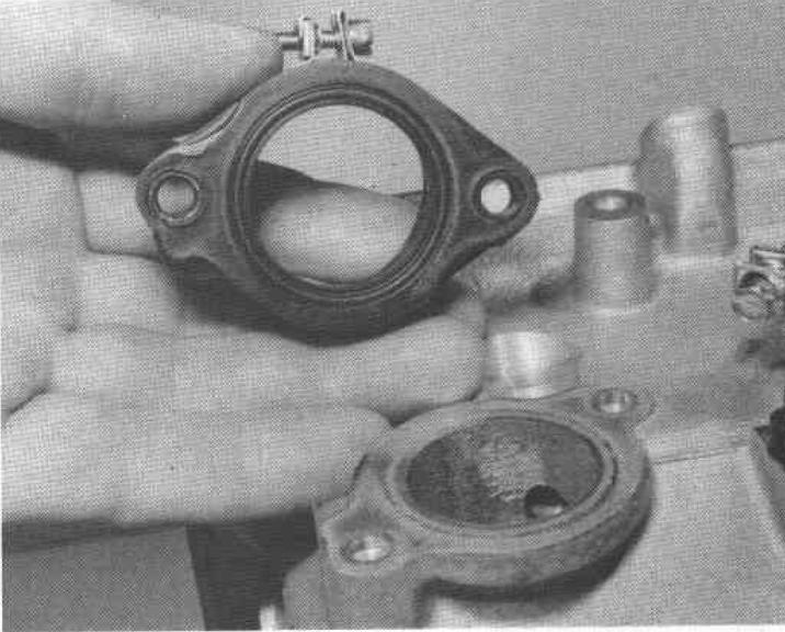

Post by: SpecialK on July 12, 2019, 07:35:28 AM
You now have 10 days to pull the throttle bodies and check for cracks in the rubber bushings above and below them.  Any cracks will allow air leaks that will mess up the running of the engine.
Is this what you are referring to Gryphon? Thanks.
* Plunum Chamber.png (67.9 kB . 716x576 - viewed 1373 times)
* Intake Stub.png (66.77 kB . 716x576 - viewed 1365 times)
Post by: Laitch on July 12, 2019, 08:07:36 AM
Can you explain where the vac ports are? I don't see that terminology in the Haines manual.
These are them.
(http://www.motobrick.com/gallery/2/1601-120719080354.jpeg)
Post by: Laitch on July 12, 2019, 08:19:11 AM
Haynes, p.147. Sometimes imagination, extrapolation or translation need deployment. :giggles

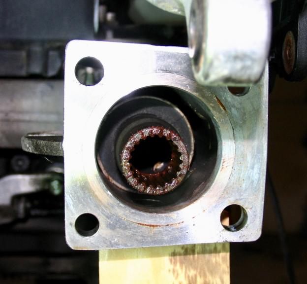

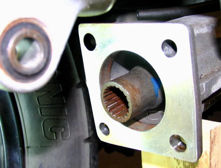

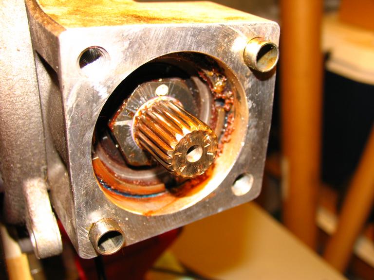

I called MAX BMW for a spline service quote. $396. I think I will use Chris Harris's video and do it myself.

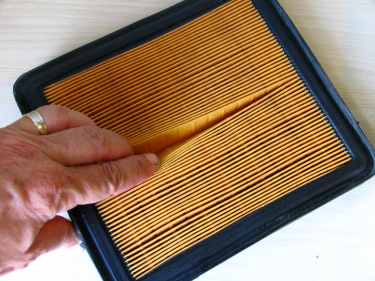

Took out the air filter today. It is a BMW Einsatz filter that looks like it was replaced just before the bike was stored. I didn't see any noticeable dirt (see photo). Save $44.

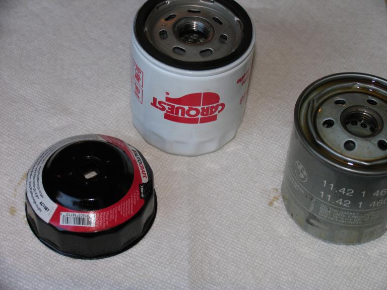

Also changing the oil today.

Possibly because of the location of the intake OEM filters are extremely long lasting and extremely efficient. I'm on my second since I bought it 21 years ago, the first is still fine. To clean I just tap it flat on a hard surface and vacuum with a industrial vacuum.
Post by: billday on August 03, 2019, 05:47:49 PM
I think the air filter is about 3 times larger than it needs to be. One of those things you think about once in your Motobrickin life.
Good on you for doing your own splines. It's a great relationship builder.
Post by: The Mighty Gryphon on August 03, 2019, 09:02:45 PM
Air filters were one of the items that back in the '80's were mandated by the EPA to have service lives of 100,000 miles.  Hence, they got fairly large, and other tricks were used to limit the dirt they had to catch and hold.
Post by: Laitch on August 04, 2019, 12:04:06 AM
In The Code of Federal Regulations, Protection of the Environment, Title 40, Parts 85 to 99, revised July 1, 1990, p.466, §86.428–80(e) indicates that air filters—among several other items—are not subject to emissions rules and their periodic change intervals are specified by the manufacturer's maintenance instructions. Their operating environment would probably be cited in those instructions, too, something like if operated in a dusty environment, inspect often, clean or replace when needed. Not that I'm trying to be contentious.  :laughing1:
The size and quality of OEM filters is just engineering excess that serves the owner and the moto well. Maybe they got a deal on them at Big Lots during the engine's development phase.

Changed the oil. Looks like all the previous servicing was at BMW or the guy bought OEM parts. Filter was BMW. I went to Advance Auto and they cross referenced the filter and wrench, 76mm. Total was around $12. Has the same rubber washer as the OEM.
* IMG_0005.JPG (55.17 kB . 768x576 - viewed 1386 times)

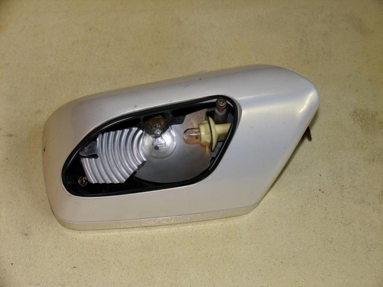

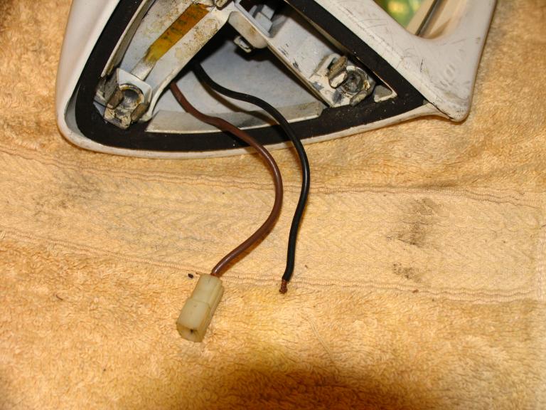

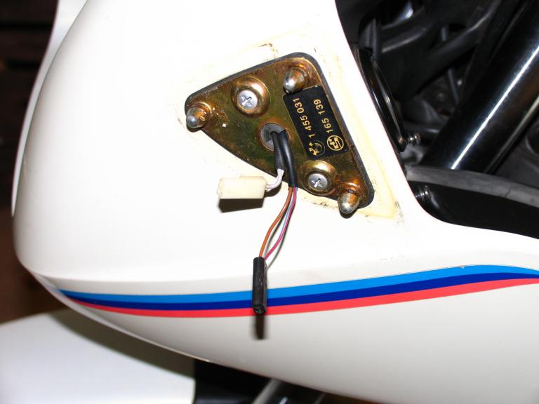

-The right mirror casing has some scratches and when I removed it, there was a white wire and plug, and another brown wire that was just hanging there with a bare end. The front signals are not working.

I took the instrument cluster out to clean the pins on the speedometer cable. I am assuming that the pins are the three on the ribbon cable in the photo. They looked clean but I cleaned them anyway.
Could there be other reasons the speedo is not working like the connection down at the rear wheel? I'm not sure where to go from here with the instrument cluster. Removing the speedo from the cluster starts getting tricky.
The trip counter does not zero out. The tens place number doesn't turn. That also looks tricky to get out and not sure if it can be fixed or if replacements are available.
The nob for the trip counter was not put in properly from a job by the PO. I have some service records that show the glass was defogged and a couple lights replaced in the early 90's. Anyway, there was a spring and a circlip off the nob but I figured out how it goes back together.
Any help for the speedometer issue would be appreciated before I put it back together.

Those three pins were rusty on my non working speedo when I got my brick. I cleaned them,  which fixed the problem, but only temporarily. I did it again, but also gave them a slight twist, to make for a tighter connection, which fixed the problem.
What's to assume? You're working from a photo with good resolution and clear labeling.
Here are more photos and text, this time concerning the odometer (http://www.motobrick.com/index.php?topic=9471.0)—a part the gears of which seem subject to deterioration. As recommended by the text's author, don't be a nancy,  :laughing1: although, at the time of the post, he was a bit of a nancy when referring  to himself as a kid even though he was eligible for service in the armed forces, was gainfully employed and likely ready to attempt reproduction at the drop of a pint. Adulthood can be scary, I'll grant him that. Of course, we really will never know the gender behind that post.
Anyway, also remove the sensor from the rear drive and clean it, if you have a screwdriver of the right type.
There's always this outfit (http://www.motobrick.com/index.php?topic=6356.0) for resolution at the end of the day.

Some good news about the nonworking speedometer. It works now! I opened the instrument cluster and cleaned and deoxited the pins, cleaned the pulse generator on the rear drive, and took apart the connector to the pulse generator and deoxited that.
After putting everything back together I tested it by putting it in 2nd gear on the center stand and turning the throttle. I got it up to 20mph and then backed off. The odometer also ticked to the next digit so all seems good for now. I got away easy on that one.

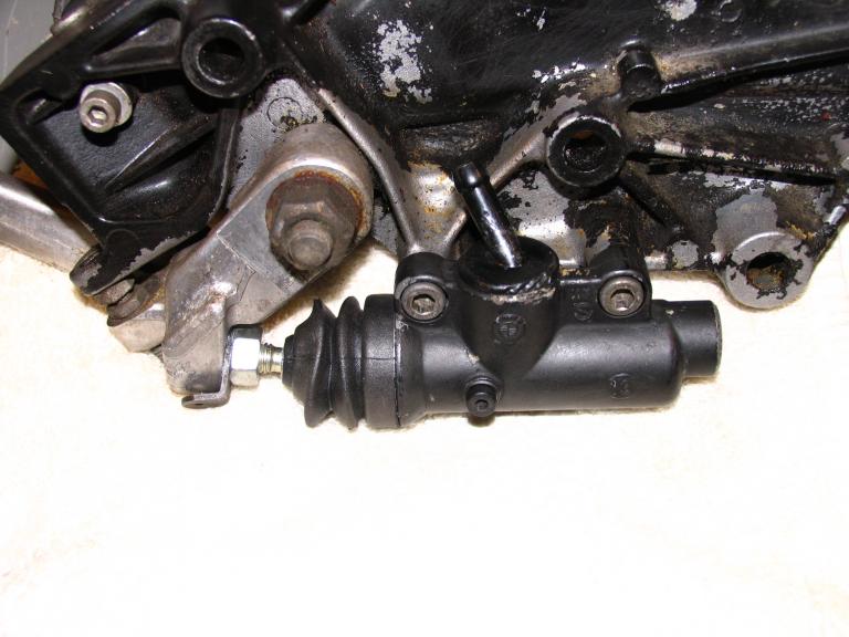

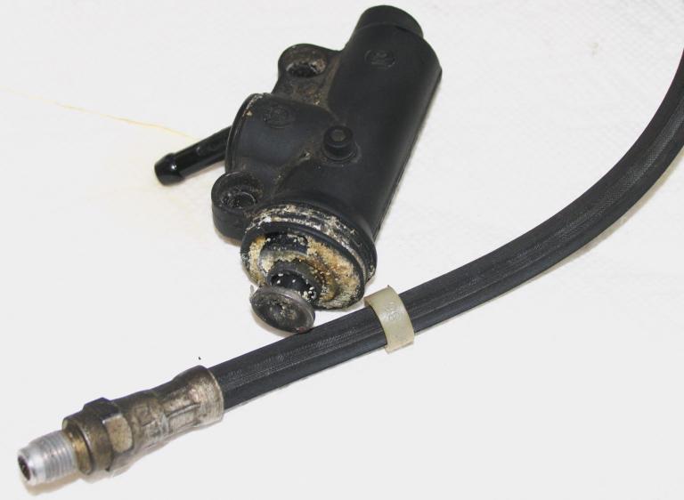

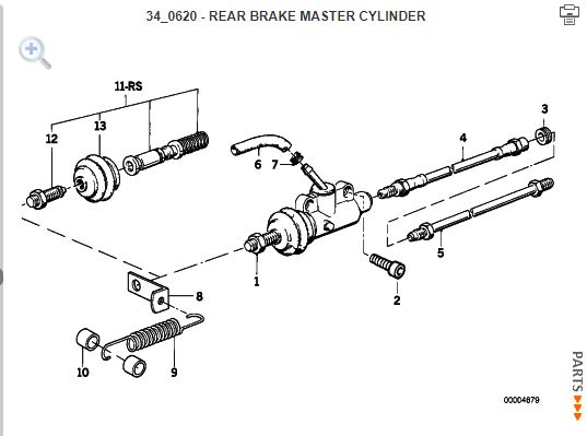

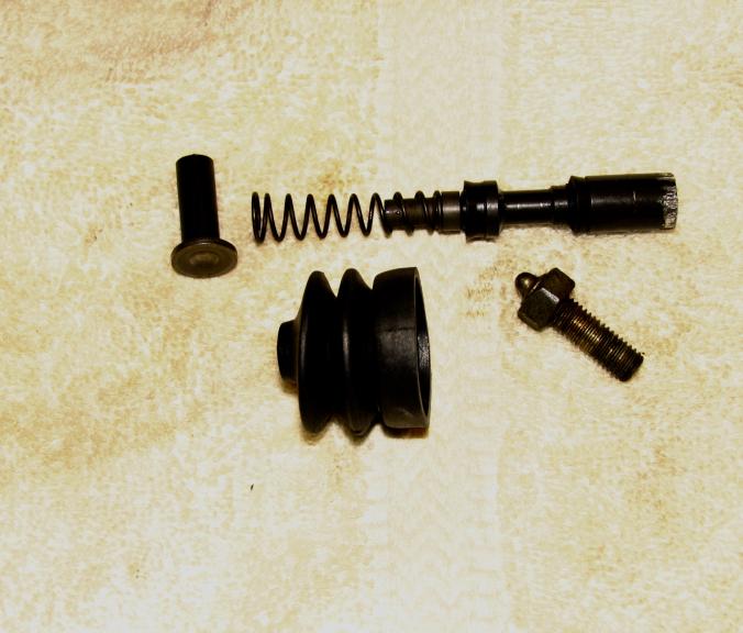

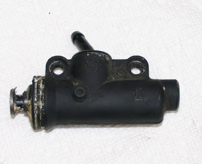

This morning I removed the right side footpeg plate and rear brake master cylinder. I have some questions below and labeled photos if you guys could help it would be appreciated.
I believe the MC is shot due to the fact I could not pump any fluid out the rear hose and the corrosion in the photo. I was able to blow air through the rubber brake hose but that will probably need replacement too. There is some corrosion from brake fluid on the inside of the footrest bracket.
MAX BMW has the 13mm master cylinder for about $150. EME has a rebuild kit for $65 https://www.euromotoelectrics.com/product-p/bmckit438.htm
Has anybody tried the rebuild kit? Is it a PITA and do you need any special tools (and patience)? Maybe better to buy the new one?
* fullsizeoutput_382c.jpeg (29.81 kB . 768x562 - viewed 1287 times)
* fullsizeoutput_382a.jpeg (34.13 kB . 708x576 - viewed 1247 times)
* fullsizeoutput_3829.jpeg (79.75 kB . 768x536 - viewed 1268 times)
Is there any way to remove the BMW crimp on hose clamps without destroying hoses? How does one loosen them to get over the nipple?

Another unrelated question. I see many hex bolts with a dab of green paint. Is that from the dealer from previous work or maybe it has anti-seize?
* fullsizeoutput_3828.jpeg (50.81 kB . 621x576 - viewed 1289 times)

Post by: Laitch on August 10, 2019, 12:56:35 PM
I can't get any emoticons to insert. I was able at first but now I get a popup window and everything is ?.
We had emoticarnage here through July—emoticons disappearing then reappearing for some members but not for others. Some of the images have been relabeled so if they were in a previous post before their relabeling, now only the text of the image's former label appears. Like with global warming, we'll just need to adapt then die.
Concerning the rear brake cylinder, TMG and Martin have installed inexpensive brake cylinders made in the PRC. They seem to be having excellent results with them. You could join the ranks. Here is the original post describing the adaptation made by Young Engineer (https://www.motobrick.com/index.php?topic=9364.0). Read through it. Since then, TMG and Martin have added more information in other posts, too.
Those clamps are called Oetiker clamps. They are considered one-time use only. I used side cutters on the pinched tab to cut them loose and didn't damage the hose to which they were attached. I replaced mine with lined nut-and-bolt style but lined worm-drive clamps will work, and many just use plain old hose clamps. The drawback with common perforated clamps is their perforations might damage hoses but you shouldn't be tightening those clamps  with a vein-popping strain anyway. :laughing4-giggles:
The green paint might have been part of a St. Patrick's Day motif but more likely it was somebody's way of keeping track of something. We'll never know. My moto has no green dabs.

Post by: volador on August 10, 2019, 02:24:39 PM
Oh by the way, I can't get any emoticons to insert.
We're not missing anything, man. Those bloody emoticons are overrated.
Some hipster probably invented those things and we need to embrace, adapt and use or it's seen as something lacking to get your thought or remark across.
You have a low mileage MC which will easily clean up with some degreaser or whatever your preferred environmentally friendly cleaner.
Use some fine grade Scotchguard to clean cylinder bore if need be.
The kit is a simple fix. One 3mm retaining screw and the piston literally pops right out.
Pre-soak the kit piston in brake fluid to get the rubber pliable.
Pack the replacement accordion cup/rubber boot with some grease to prevent future crud intrusion.
I use standard plumbers high temp grease found at the local plumbing supply or Home Depot, etc..
More MC info
http://www.motobrick.com/index.php?topic=291.0
Oetiker clamp are usually 1 and done use. You may try using needlenose pliers, O-ring remover, a pick or scriber to loosen but its difficult.
A sharp pair of cutters is best for removal
https://www.youtube.com/watch?v=weQu8GrHALg
BMW recommended oetiker clamp replacement  17111460862
(https://shop.maxbmw.com/fiche/NotesParts/17111460862_3_B.jpg?rnd=1728011)

Concerning the master cylinder, TMG and Martin have installed inexpensive master cylinders made in the PRC.
If your hanging at the yacht club or lounging in a hammock sipping cool drinks with plenty of spare time on your hands and feeling extra mechanical
 that Chi-com MC could be your next project.  :laughing4-giggles:
Post by: Martin on August 10, 2019, 04:13:36 PM
Over 2 years now running the Chicom master cylinder with no problems. As per Volador I pack silicone grease under the master cylinder boot and have done so for over thirty years. I still have my OEM one which I had just re-kitted before the Chicom experiment. Due to it having been packed with grease it has no corrosion. It is important to thoroughly clean out any old brake fluid and coat with a smear of rubber grease internally, before putting into storage. Old brake fluid will eventually crystallize.

Post by: The Mighty Gryphon on August 10, 2019, 05:31:52 PM
My advice is to avoid taking a chance on pissing away $65 on a rebuild kit like I did(twice) and just get a $12 Chicom master cylinder and spend an hour or so putting it on your ride.  Then you can spend the rest of your money on fuel to go someplace.

Post by: SpecialK on August 12, 2019, 02:23:01 PM
At least I am going to try this: http://www.kbikeparts.com/classickbikes.com/ckb.tech/0.ckb.tech.files/master.leak/master.leak.htm I think this article has been referenced in some other threads. Makes sense to see if I can resurrect the old MC before doing anything else.
Will try this afternoon when I get home.

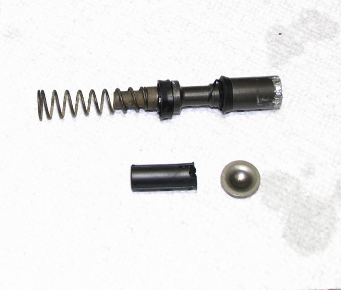

6:45PM----Ok, took the 3mm screw out but nothing is coming out of the cylinder.  Is the piston and spring supposed to pop out easily? I tried gently tapping, pulling etc. but nothing coming out. I set it in some cleaner for now to see if things loosen up. I don't want to start grabbing things with the needle nose for fear of marring.
Post by: Laitch on August 12, 2019, 09:18:37 PM
The piston of a brake cylinder manifesting the condition you have described is unlikely to "pop out". If you're using a brake cleaning compound as a soak, you're on the right track but it might take soaking in Liquid Wrench, PB Blaster or some other elixir to work through the corrosion. Judicious use of compressed air into its inlet might move it out after its soak. A bicycle pump might generate enough pressure if attached well-sealed. Point the cylinder at something that will cushion the piston, absorb its impact, and keep it in the neighborhood when it releases. Remember to use eye protection—perhaps fabricating something out of leather seat covers. Safety glasses and patience should be enough though.

Post by: SpecialK on August 14, 2019, 09:20:32 PM
If the master cylinder is off of the bike and disconnected from the brake line, you can dissolve the crystallized brake fluid by a short soak in hot water.  After the parts separate, dry them off and blow any remaining water off with compressed air.
I soaked the parts in soapy hot water but nothing was coming apart. I ended up putting the housing in a vice and clamping a channel lock plier onto the plunger end and turning. After much marring and trying to twist it finally started to turn and I could hear the spring turning but it took some twisting and tapping the pliers for it to come out. the inside of the cylinder looks clean but hard to tell.  I am soaking for a while the see if it will clean up.
The plunger/spring looks good except the tip where the pliers scraped it up. How does it go back in though? does the other end where the hose screws in come out?
I think I have four options; get the retro fit from China, Buy the rebuild kit for $67, buy a whole new master cylinder assembly from MAX for $152, or try to reuse what I have.
Now that I am looking at the photos, the MC doesn't look to be in good condition so may have to go the Chinese or new OEM route:
* fullsizeoutput_3833.jpeg (30.05 kB . 613x576 - viewed 1158 times)
Marred up tip. Not good. Little plate on the end of the plunger insert came off.
* fullsizeoutput_3835.jpeg (26.94 kB . 676x576 - viewed 1217 times)
Is inserting to the left the only way for this to go in? The taper on the plunger bushings is against the grain.
* fullsizeoutput_3834.jpeg (19.43 kB . 768x335 - viewed 1167 times)
Thanks for you help.
Post by: Laitch on August 14, 2019, 10:58:45 PM
A moment of clarity has revealed to me that for a brake cylinder to be a master cylinder, it must control a slave cylinder. These motos only have one front brake cylinder and one rear brake cylinder.
Anyway, your rear brake cylinder parts are junk when viewed from where I sit on the porch of The Ridley Brook Butterfly and Hummingbird Preserve Gun Club. I recommend replacing the entire rear brake cylinder assembly and also replacing the brake fluid reservoir with a cylindrical container that can hang on a frame member beneath the right side cover away from the effects of sunlight on its integrity.
Post by: SpecialK on August 15, 2019, 01:03:51 PM
Yes but if there is no slave then the Master is truly a Master. Maybe of his own destiny, or maybe he's the Master of the brake hose? Anyway, the Fiche calls it a rear brake master cylinder.
* Rear Brake Master Cylinder.JPG (33.5 kB . 537x399 - viewed 1199 times)
Those suggestions sound wise and in line with what I am planning. Thanks

Post by: SpecialK on August 22, 2019, 07:57:44 PM
Received the master rear cylinder rebuild kit. The cylinder bore cleaned up nicely with 0000 steel wool so I went ahead and ordered the kit. Also have the calipers off so will check all of them and bleed the brakes when I get back from Maine on the 28th.

Post by: SpecialK on August 30, 2019, 05:43:53 PM
I am off to a slow start getting back to the K100 project after vacation but this Labor Day weekend should be productive. One issue I need to start attending to is the right front turn signal. It has some light scrapes that look like from a drop at some point and someone must have botched the wiring when repairing.
I did check the wiring diagram but it is hard to see the color codes. Can someone tell me from the two photos what I need to do to reconnect and get working? Obviously one connector on the black wire is missing. Do I need to splice a new connector on?
Thanks.
Fairing wires
* IMG_0002.JPG (38.7 kB . 768x576 - viewed 1121 times)
Wires from right unit
* IMG_0004.JPG (77.99 kB . 768x576 - viewed 1225 times)
Post by: johnny on August 30, 2019, 07:41:59 PM
that is not oe... are both the left and right side turn signals wiored the same...
no telling what has happened here... mirror mounted driving lights... could be anything...
you are gonna have to test those with a meter... key off key on flasher off flasher on... you getts the idear...
the mirror signal connector only slides in one way... its the white one...
the other connector... the black one... gonna have to trace those wiors back to the hot ground switch if any to figger that out...
Post by: Laitch on August 30, 2019, 09:02:18 PM
Blue/Black and Brown wires. Blue/black runs to the flasher unit, brown to ground.
(http://www.motobrick.com/gallery/2/1601-300819210002.png)
Post by: SpecialK on August 30, 2019, 10:46:30 PM
Thanks, mine was pixelated so I couldn't read it. It would seem then there should be a blue/black/brown connector on the blinker housing instead of a bare black wire and a brown wire with a connector.

Post by: SpecialK on September 02, 2019, 09:48:57 AM
Thanks Laitch for the diagram. After further examining of the mirror/blinker assembly, I noticed a plug socket that takes the blue/black and brown wire. So the black and brown wires are extra and run to an inserted bulb installed by the PO (see photo). The bulb is not attached and is just laying in the housing so I can take it out easily. The blue/black/brown on the right, and blue/red/brown on the left were not plugged in when I removed the mirrors, just the extra white/brown wires running to the extra bulb were connected.
My two questions would be:
-What was the purpose of that extra bulb? Heat the mirror?
-Do I need to trace back and remove the extra white/grey leads that run into the fairing or can I just leave them there?
extra bulb
* fullsizeoutput_3868.jpeg (42.36 kB . 768x576 - viewed 1146 times)
black/brown wire to extra bulb
* fullsizeoutput_386a.jpeg (40.46 kB . 728x576 - viewed 1121 times)
fairing with stock blue/red/brown wire and extra white/grey wire
* IMG_0003.JPG (40.41 kB . 768x576 - viewed 1170 times)
Post by: johnny on September 02, 2019, 10:07:23 AM
rodger that... i use heated grip elements to heat my mirrors...

* symtec_heated_mirrors.jpg (33.39 kB . 576x576 - viewed 1098 times)
So you think those little bulbs were to heat the mirrors? Much simpler system than yours.
Post by: johnny on September 02, 2019, 11:08:40 AM
of course... why else would somebody putts a heat source in there...
look... if you not running heated grips... heated mirrors... heated peggs... heated seat... and remote start in and abouts the hudson river watershed then you just whack...
Post by: SpecialK on September 02, 2019, 11:32:07 AM
Haha, I guess you do have a point!

Post by: SpecialK on September 02, 2019, 01:57:46 PM
Update:
I hooked the blue/black/brown and blue/red/brown back up and now the turn signals work fine but I have no parking lights.

Post by: SpecialK on September 02, 2019, 04:28:00 PM
Got the rear wheel and final drive section removed. I have not done this before but from what I have read and seen the splines look good with no "steps". The grease in there was brownish red.
See before and after cleaning photos:
Rear section before
* IMG_0002.JPG (71.21 kB . 768x576 - viewed 1101 times)
* IMG_0013.JPG (46.67 kB . 768x576 - viewed 1117 times)
Rear section after
* IMG_0007.JPG (63.95 kB . 768x576 - viewed 1068 times)
* fullsizeoutput_3874.jpeg (56.9 kB . 768x576 - viewed 1152 times)
Drive shaft section before
* fullsizeoutput_3872.jpeg (40.85 kB . 624x576 - viewed 1190 times)
* IMG_0004.JPG (45.59 kB . 768x576 - viewed 1151 times)
Drive shaft section after
* fullsizeoutput_386d.jpeg (49.37 kB . 756x576 - viewed 1074 times)
* fullsizeoutput_3870.jpeg (38.48 kB . 633x576 - viewed 1161 times)

Post by: SpecialK on September 07, 2019, 04:30:58 PM
Spent the day Friday on the rear splines and brakes. lubed the splines and reinstalled the rear drive. Used Enduralst molybdenum based grease from EME. Took apart the rear caliper and cleaned then using the new rebuild kit rebuilt the rear brake cylinder and reassembled everything onto the footpeg plate and attached. When I removed the main bolts that hold the caliper to the rear drive, I striped one of them. I went to MAX a picked up a new set. The new caliper bolts are 50 Torx, not 6mm hex like the originals. Put new DOT 4 fluid in and bled the brakes. The brakes are working properly now.
I then proceeded to drain and bleed the front brakes with new fluid. These brakes were working when I bought the bike but I wanted to change the old brake fluid. After I started messing with bleeding I noticed brake fluid seeping from under the reservoir. Looks like a tear down and cleaning of the front brake cylinder is in order. According to the section Johnny posted on brakes and Frankenduck's comment, I may be able to get away with just cleaning instead of a rebuild.
So now most of the main issues are resolved and the bike is getting near inspection status.
Rebuilt Rear Cylinder
* IMG_0009.JPG (57.11 kB . 768x576 - viewed 1103 times)
Old cylinder parts
* fullsizeoutput_3882.jpeg (48.09 kB . 676x576 - viewed 1120 times)

Post by: SpecialK on November 15, 2019, 10:39:17 AM
One more question about the Merit/accessory plug;
Is the wire that leads off the back hardwired into the battery leads? Looks like it goes up under the relay box somewhere. I can't trace it without removing the tank etc. so was hoping for a quick answer.
I don't see any wire going directly from the Merit plug to the battery terminals.
Now that I look at the part diagram, the wire is terminated with those little slip on flat connectors (not sure the name?) so would probably connect somewhere other than to the battery terminals.
I would think if is connected to the battery it would have power going to the plug and could be tested with my volt meter but the volt meter is dead right now. Can it be tested this way, by touching the inside of the plug wall - and to the + at the back of the plug?
Post by: Laitch on November 15, 2019, 11:29:51 AM
I would think if is connected to the battery it would have power going to the plug. . .
Those are called spade connectors.
The power socket is usually connected to fuse #4; that's the setup on my moto. Get yourself a cheap circuit tester with a 12V light bulb in it.

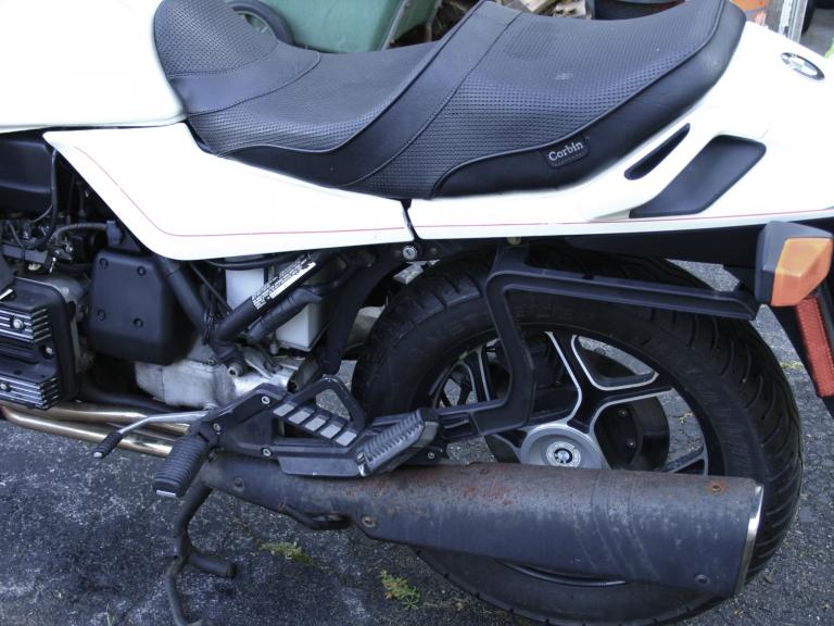

Post by: SpecialK on March 28, 2020, 06:19:53 PM
By the way, I bought a new OEM muffler heat shield to replace that rusted one in the photo. $65 new but I think it's worth it.
