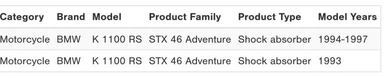

I had an Ohlins on my 91 K100RS and would like to be on the hunt for my 95K1100RS.  Ohlins does not show a shock now and I contacted them and standard response was our system does not show to have a shock for your bike.
Its a paralever guys.  Anyone have or remember the part number for a K bike shock?  Mine had the remote reservoir.

abs1 and abs 2 are different... luckily for you both will works cause you aints gotts abs 1...
ohlins no longer makes the 46 for the k... gonna have to keep looking at ebay and boner beamyard and places like that...

Post by: Scott_ on May 08, 2019, 07:10:27 PM
Surprised that the same shock was listed for both model year groups, I was able to get my Ohlins from a friend because it would not fit his ABS1 1100RS....
So after a bit of more detailed research...... the specific product # for the ABS1 model is "BM309" and the part # for the ABS2 model is "BM420"
As was mentioned they are officially discontinued, though if you can find a used one, they can repair/rebuild it for you. I had mine done 2 years ago.
