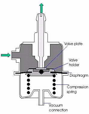

The first two vacuum outlets have rubber blanking caps the last one near the TPR has a hose that supplies vacuum to the FPR. [ Invalid Attachment ]
Title: Re: Fuel in engine oil
Post by: Soggz on March 13, 2019, 06:48:08 PM
* Fuelpressureregulator.jpg (14.55 kB . 295x379 - viewed 582 times)
Thanks Martin.
Can that ' backfire' fuel back into the system via the to inlet? Not sure of these engines. Do I look for fuel traces, I.e,wet? in the pipe? What would cause this,if so? Dodgy regulator?
Thanks in advance.
