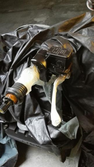

you still gotts the oe rubber brake lines on there...
is this what it looked like...
* K1100LT-5.jpg (30.35 kB . 324x576 - viewed 396 times)

Post by: zalle on March 13, 2019, 04:18:30 AM
Hi, I replaced front rubbers.
