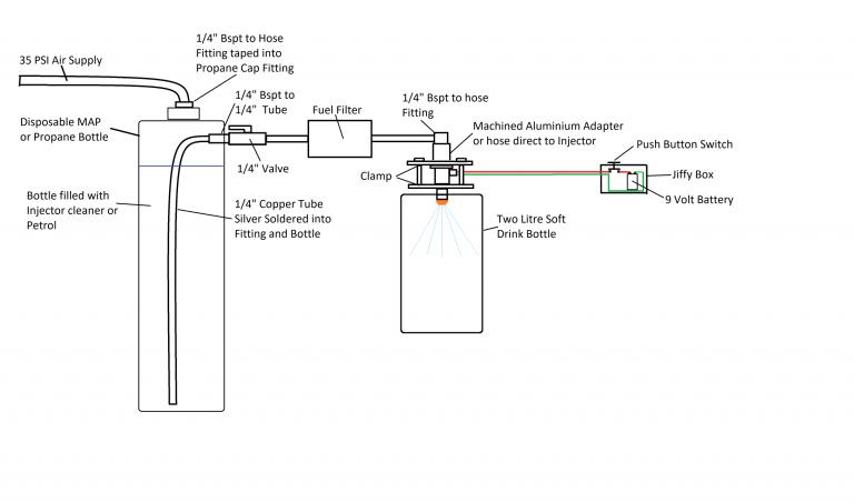

I made up an air powered set up to pressurize the injectors adjusted to 36 PSI and bought the injector pulsar (Ebay) to activate them. I use a graduated vessel and time the flow while checking the pattern. A local workshop that also does injectors advised me to stop using injector cleaner and use lacquer thinners as it is more economical and cleans better. I tried the thinners on some injectors that were totally blocked and had resisted cleaning with injector cleaner, and they cleared. I also soak them sometimes in a sonic jewelry cleaner (Aldi) while activating with the pulsar.

Post by: Martin on February 22, 2019, 01:10:48 AM
Chaos I air powered mine to avoid any chance of BADDA BOOM.
* Fuel injector pulse tester plan.jpg.png (26.83 kB . 768x452 - viewed 1453 times)
