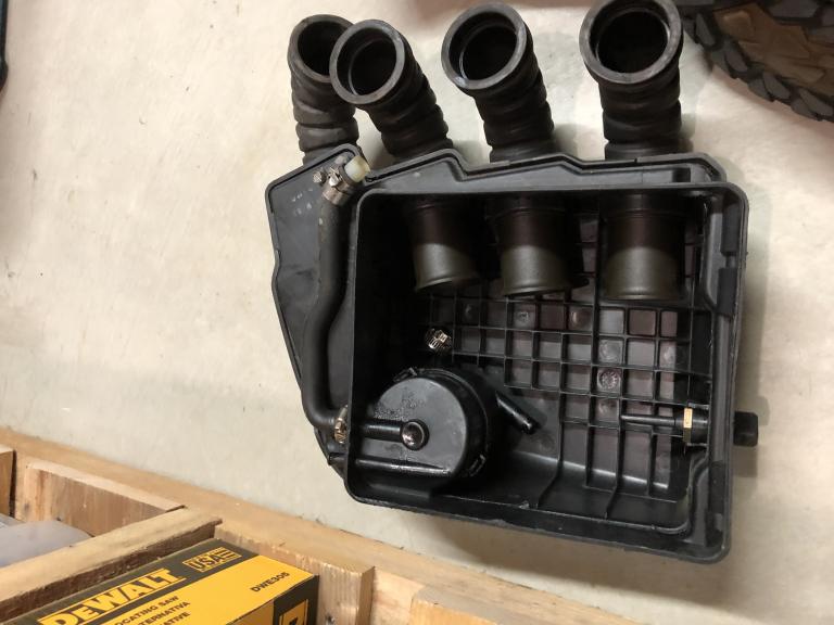

I took the air box out,
These are going on this bike
Title: Re: Café for a k1100
Post by: Cromoly on February 06, 2019, 09:51:30 PM
But i still have to figure it out
Post by: Barry in IN on February 06, 2019, 10:01:31 PM
Can’t pass this one up!
Me too.
Post by: Arktasian on February 07, 2019, 09:25:10 AM
* C784FCA9-50C7-494E-8A9D-17EFBFCDB5AF.jpeg (51.64 kB . 768x576 - viewed 1127 times)
* C23F9F49-6D82-4C03-BB0C-1BDD1AF00C14.png (19.71 kB . 323x576 - viewed 1062 times)
"But I still have to figure it out"
If you are removing the stock air box to fit individual cone filters on the inlets, how are you going to accommodate the removal of the MAF sensor that resides in the box, and communicates air flow to the ecu? That is not an optional item, assuming you are maintaining the stock ecu.
Post by: Laitch on February 07, 2019, 11:36:13 AM
The K1100 engines don't have a volume air flow sensor in there like 8V engines have. The gizmo in Cromoly's photo is part of the crankcase ventilation system. From what I've read, the Motronic uses air temperature and throttle position as part of fuel mixture calculation. That is part of what Cromoly will need to figure out.
Post by: Arktasian on February 07, 2019, 01:25:58 PM
I stand corrected. :embarass:

The "accumulator" in the stock airbox is essentially an oil catch can. So, ideally, you would replace the stock configuration with an aftermarket catch can.
[/quote]
I guess i could make a small catch tank similar to the cooling one, out of aluminum or anything really...
Post by: Laitch on February 25, 2019, 05:13:11 PM
A juice box probably won't be as durable as aluminum. I think you're headed in the right direction though.

I dug into this a little bit last night. You inspired me.
I actually ran my bike with the airbox and all breather hoses removed and observed air flow (BTW, it ran perfectly).
1. The rear breather hose had a steady stream of air venting from the crankcase.
2. All other hoses have no air movement at all. Both at idle, acceleration and holding RPMs. That indicates to me they are just returns for the positive pressure from the rear vent.
3. I noted that the hose running along the throttle body connects into the TBs BEFORE the butterfly valve. That indicates to me that it would never present a vacuum to the hoses that connect to it. It really is just an air re-circulation. As such, I really don't actually think it's necessary.
With that in mind, I have the following thoughts:
I would not put the rear crankcase breather directly to the TB hose like that picture. That is just asking for oil to enter the system. Either keep it with just a breather, or run a catch can. Putting just a breather does introduce the potential for some oil to leak out of the filter if it spits some out. I'd rather have it dripping/leaking than to have it enter the intake.
I'm planning on doing what you're doing. Just going to run a breather filter. If you look at pictures of the La Dini k1100, you can see that he also just has it venting to the side of the bike with a pod filter.
From the front crankcase hose, I did what you did and just jumped that over to the Y-fitting that is on the TB hose. I don't actually think any air flows FROM the front, so I don't think you'll ever get any oil spitting entering the TB (might want to monitor it, though). I also believe that you could probably plug it up, with zero consequence.
From the front crankcase hose, I did what you did and just jumped that over to the Fitting that is on the TB hose. I don't actually think any air flows FROM the front, so I don't think you'll ever get any oil spitting entering the TB (might want to monitor it, though). I also believe that you could probably plug it up, with zero consequence.
Thanks for your interest, late response, real work got me busy...
You are right, the front breather should not do much, the rear breather is the on i am concerned about.
Others have build a hose assembly that joins the vent to the front of the TB via calibration holes using a one way valve (from other source).
From what i understand, the engine needs this negative pressure to work properly,
So by plugging under the butterfly, It solves this issue.
Monitoring will be done often... [ Invalid Attachment ]

To me, I don’t think it really needs a vacuum in order to properly vent the crankcase. And again, doing so, you risk sucking oil into your intake.

To me, I don't think it really needs a vacuum in order to properly vent the crankcase. And again, doing so, you risk sucking oil into your intake.
You may be right, i have a small pod filter on order and a one way valve on order as well, i can do both and test. I guess i can put the filter on the breather for now and see. The setup would be the cleanest and most
« naked »
You did mentioned you ran your bike with the hoses unplugged, did you get any oil residue ?
It is the main reason i wanted to put a one way valve on the hose line.
