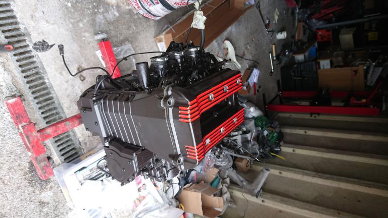

Did the valves, they were massavly out f spec now tip-top condition. Soda blasted the engine and sprayed black with red details

Post by: natalena on April 13, 2019, 09:45:14 AM
Looks nice. Did you figure out the transmission issues? With luck, you'll have 2 or 3 sunny days of UK Spring to work on the bike. ;)
Title: Re: K75s CR by arthur229
Post by: Arthur_229 on April 13, 2019, 09:48:59 AM
Didn't bother opening it and just got another gearbox from a k1100
