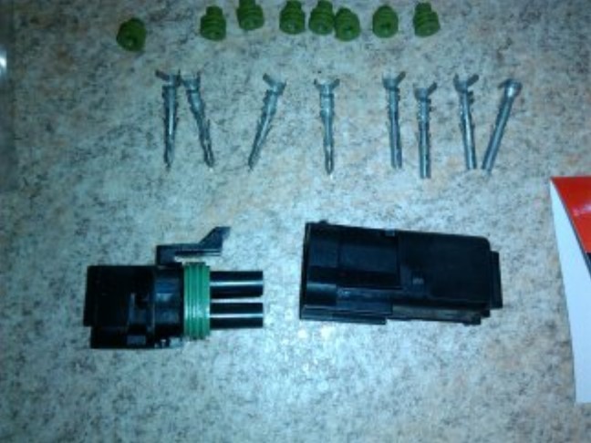

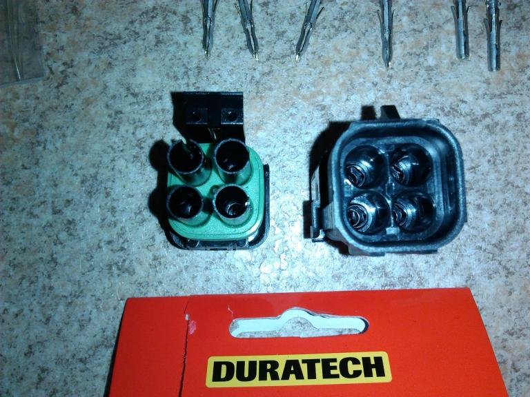

Post by: Martin on December 18, 2018, 09:38:26 PM
For the amount of problems caused by the 4 pin connector. And the stuffing around I and others have gone through trying to get it to work consistently. And I came to the conclusion pretty quickly I would replace it as a matter of course. For the $20.00 and hour it took I now have peace of mind. Any electronic store should be able to supply one.
* Duratech 2.jpg (84.34 kB . 768x576 - viewed 1650 times)
* Duratech 1.jpg (68.18 kB . 648x486 - viewed 1626 times)
