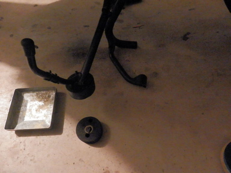

I used  slice of rubber boat roller. I had to counter sink the bolt holes and use washers in order to protect the heads and stop it pulling through.
* BMW sidestand foot 1.jpg_thumb.png (594.64 kB . 768x576 - viewed 1334 times)
