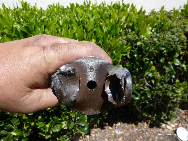

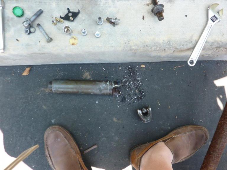

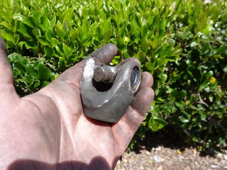

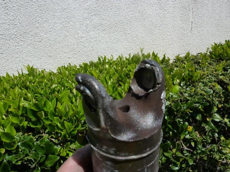

Post by: johnny on November 02, 2018, 02:25:20 PM
* 010.jpg (57.42 kB . 768x576 - viewed 1270 times)
* 011.jpg (107.21 kB . 768x576 - viewed 1230 times)
* 013.jpg (79.84 kB . 768x576 - viewed 1246 times)
* 012.jpg (77.75 kB . 768x576 - viewed 1330 times)
its the metal that surrounds to ujoint... its not robust enough in my opinion... its always that metal that lets go and causes a rear tior lock up... that is your challenge... how to build it up effectively...
http://www.motobrick.com/index.php/topic,240.msg260.html#msg260
