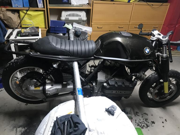

Hi everyone!
Here’s some updates on my work so far :
Front wheel is on but need to work on axle bushes. I have still to fabricate some brackets for the new calipers. I would like to use aluminum for the brackets, will see.
Fork yoke from Twisted Brothers. strap-ons from Cafe4racers. Original instrument bracket I’ll try to use as bracket for the front fairing.
Have some new Bosch injectors. Do they need some tuning? Will this swap affect idle?
New old k1100lt gearbox with final drive from same model.
Rear wheel fitted. No modifications needed. Except for the final drive lock(cap?) which is from a r1100gs and that one came with a caliper from same bike (or at least same model).
New rear shock and some awesome Pirelli MT60RS.
Motogadget Munit in progress. Looks like a mess but I think I came around most of the big issues. Still need to cut useless wires and relays from old harness. I did not had the guts yet :)
I’m thinking about modifying fuel tank. Give it a more straight line at the base. Will see.
What are your thoughts so far?

Post by: Laitch on November 14, 2018, 07:39:44 PM
You've made significant progress. Did the engine of this moto run well before you started remodeling it? Did you ride it much?

Post by: bocutter Ed on November 14, 2018, 08:00:32 PM
And the front fairing. Will need to fabricate some bracket for this cause I can’t find anything on the web that I can modify to fit . I’ll keep that for last maybe.
I'm pretty sure the upper (pointy) bolts from the original bracket also hold the 'fluid-bloc' in place ...

Post by: Flodabo on April 18, 2019, 11:31:18 AM
So here is the main subject of this thread : a cnc machined bracket to make possible fitting the r9t front wheel.  [ Invalid Attachment ]  I’m not sure if I should leave it like it is or painted black. Any thoughts?
Title: Re: Fitting a RnineT front wheel to a K75 1988
Post by: Flodabo on September 25, 2019, 02:05:03 PM
Here it is gentlemen. Isn’t she a beautiful lady? :) I want to thank you all for being so helpful and for your time during the last 12 months.  Bike has cleared inspection by Swedish authorities and is now read for DGR ride this weekend!

Post by: Shonkster on June 11, 2020, 08:59:18 AM
Looks awesome Flodabo,
Any chance you could post details of the front axle.  Interested to know if you needed to change bearings, spacers etc and if you had part numbers for those.
Cheers
Post by: Flodabo on June 11, 2020, 09:11:05 AM
Cheers
Hello Shonkster,
I used the K75 axel but had it machined a bit. R9t wheel came with bearings that fit spot on on K75 axel. Spacers from K75 cover the r9T wheel bearing almost perfect so I used those, again machined a bit.
Good luck with your build!

Post by: Flodabo on June 11, 2020, 11:59:16 AM
Please verify if the tank was modified to straighten its lower profile and, if so, how that was accomplished.
Hi Laitch
Tank is under a home made carbonfiber cover and in order to have that shape I had to move tank backwards a bit.
Post by: Laitch on June 11, 2020, 02:02:26 PM
Hi Laitch
Thanks for the clarification. Yours is a thoughtful customization and it can serve to show that fenders can be integrated into a compelling design; there is no particular need to be spewing water, mud and gravel in your wake, up your backside or into the works of the moto.
