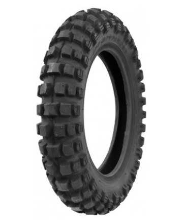

Post by: johnny on September 22, 2018, 08:08:12 PM
here is a 6 ply with nice steering tread...

Post by: johnny on September 24, 2018, 03:54:52 PM
* tior01.png (93.21 kB . 366x437 - viewed 6537 times)
