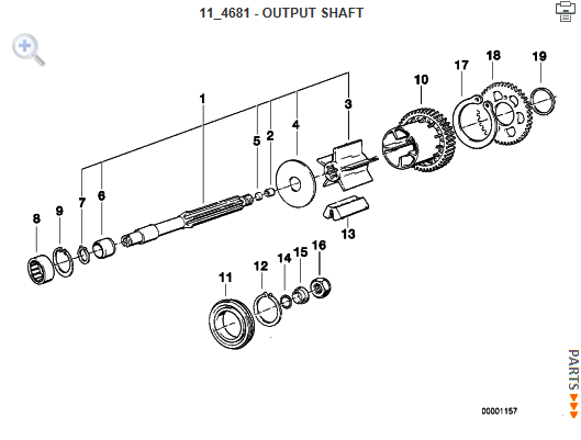

All fluids except forks are now drained and the bike on the lift. I managed to get 3 of the 4 exhaust clamps up stream of the collector free but the hardest to reach one was solid and had to be cut out. I intend to get the silencer out next time home and remove the headers. The bolts on the manifold are terribly corroded, I had soaked them for a day or two in PlusGas and had an attempt at one after cleaning the surface as much as I could but it just rounded in the socket. Does anyone have any top tips for getting the exhaust headers off?
I've noticed there is quite a lot of oil from the the gearbox bell housing where the swing arm mounts, is that likely to be the output seal?

Yeah, oil in the bell housing does sound like a bad rear main seal.

Servicing the water/oil pump, replacing rear main seal and of course lubing the splines is what I can think of off the top of my head.

Title: Re: Triple S
Post by: Skunky on April 24, 2018, 05:43:13 PM
This output shaft?
* Output shaft.png (37.14 kB . 529x401 - viewed 2352 times)
If not you should be able to find the part number here.
https://shop.maxbmw.com/fiche/DiagramsMain.aspx?vid=51747
Full set of Fiche diagrams with part number lists.
Title: Re: Triple S
Post by: Skunky on April 24, 2018, 05:45:31 PM
Title: Re: Triple S
Post by: DJEwen on April 24, 2018, 05:51:22 PM
Hi Skunky, yeah I’ve got it now, Laitch managed to help me out  :yes. Thanks though.

Promised to share some spline shots.
Thoughts on the splines?
(http://www.motobrick.com/gallery/1/5327-200518120617-1275951.jpeg)
(http://www.motobrick.com/gallery/1/5327-200518121051-12812209.jpeg)
(http://www.motobrick.com/gallery/1/5327-200518120545-12731884.jpeg)
(http://www.motobrick.com/gallery/1/5327-200518120607-1274628.jpeg)
(http://www.motobrick.com/gallery/1/5327-200518120734-12761382.jpeg)
(http://www.motobrick.com/gallery/1/5327-200518121003-12802444.jpeg)
(http://www.motobrick.com/gallery/1/5327-200518121228-12841148.jpeg)
(http://www.motobrick.com/gallery/1/5327-200518121146-1282695.jpeg)
Title: Re: Triple S
Post by: Laitch on May 20, 2018, 12:25:15 PM
:2thumbup:
Title: Re: Triple S
Post by: DJEwen on May 20, 2018, 12:55:19 PM
:2thumbup:
That’ll do me!

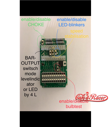

So... the BEP 3.0... Apologies in advance if I’m being a total idiot. I have a wiring diagram for the Acewell and the K wiring diagram. The BEP is ‘simple’, right, you plug the main plugs from the original dash in to their respective ports, you then terminate from each labelled output to their respective component and that’s it? Is that it? What I’m not clear on are the original cables that don’t form part of those two plugs, example: Headlight or flashers. What happens to those, they still terminate to their respective relays. Do they need to run from the relays into the outputs of the BEP then jump on to the specific component? The BEP didn’t come with a manual either which isn’t helping my confusion. I’ve searched a lot of threads that have detail regarding certain aspects of the BEP but it doesn’t appear anyone’s posted a detailed installation thread.
Thanks in advance

Wow what a mess. The BEP was relatively easy to install you just have to make sure that you get the right polarity for each output. As I said just now the LED indicators won't need resistors as Marulabs have fitted a switch and internal resistors.
If you go to Café racer 4 u you can download detailed instructions for fitting with an acewell written in English by Marulabs.
https://cafe4racer.eu/en/others/296-marulabs-bep-3.html
It goes into much more detail than any thread I've seen and made it much easier.

So, you’re saying you just left in all the original sections but run new cabling from the outputs of the BEP?
This was where my confusion lay “what about all the original cables and terminations” They just become redundant? Do most just snip them and forget about them, except yourself of course?

The BEP is for the Speedo only. The terminations are for the lights on the speedo or any other idiot lights you may want to use.

Hi Skunky. The Acewell CA 85 comes with Oil, Water, Fuel, High Beam, Shift Light, Indicators, Neutral and a load of other functions, here's a link: http://www.acewell-meter.co.uk/Acewell%20Speedometers/ACE-CA85/CA85+Modern+Face.htm?currency=GBP&action=full&id=302 (http://www.acewell-meter.co.uk/Acewell%20Speedometers/ACE-CA85/CA85+Modern+Face.htm?currency=GBP&action=full&id=302)
I do intend to have a fuel light, from what I've researched on the forums to date, I understand the Acewell and BEP 3.0 senses the level easily with 1985 (pre float) electronic sender and that it indicates a fuel light at 7L - I could be wrong though??
Yes, the BEP 3.0 has a circuit to sense 7L threshold on the pre-85 fuel sender and trigger a lamp.  The signal is active LOW meaning it goes to ground potential when activated.  This only works with inputs on the CA85 that are also active LOW.  Acewell is not specific in the manual whether the low fuel light is active HIGH or active LOW.

Installation of the BEP 3.0 with the Acewell CA85 was really easy after all. I ended up not needing the 12 core cable as there is enough length on the Acewell harnesses.
I performed the flasher relay PIN 7 snip modification and the signals worked perfectly.
https://youtu.be/hM5AFXJQTrQ (https://youtu.be/hM5AFXJQTrQ)
I have yet to wrap the grey RPM wire around (I believe) the number 1 cylinder spark plug lead. The speedo reading seemed to be delayed, the Acewell instructions give values to programme in for specific tyre diameters, mine measure 26” so I will programme this in.
The only gauge function that didn’t appear to be working was the backlight, I’m unsure why as I terminated B-Purple to BT Backlight check on the BEP- this may be incorrect?

Good job.  The backlight on your Acewell is operating in the video.  What do you think you should see?
P.S. The BEP 3.0 outputs engine RPM signal compatible with the Acewell on the RPM pin 24.  Why would you go the route of wrapping a wire around the spark plug?

Ahh... OK. I have already terminated B-Yellow RPM on the Acewell to RPM on the BEP but I had read a thread some time ago on the K100 forum that the Grey should also be used, that may have been the 2.0 however.
What’s the normal connection point for the terminations to the BEP outputs? I merely stripped the sheaths and soldered the ends for some rigidity and inserted in their respective ports.

Ah, that lack of dial illumination is not apparent on the video because of the high ambient light.  Yes, I think there should be a backlight and I believe it is supplied from B-Red.  Try to power the B-Red (switched 12V) and Brown (unswitched 12V) directly from the battery temporarily.  If the backlight comes on, you have a wiring problem or a BEP 3.0 problem.
Yes, the grey wire idea applied to BEP 2.0, but was solved in BEP 3.0.  It's better to use the BEP outputs for RPM and speed since they are properly conditioned.
I thought the light may have been giving false impressions.
I currently have B-Red terminated to SWP Switched Power in the BEP, is that not correct?

Dave,  With regard to the needle situation you may need to put a conditioning circuit on the RPM output to smooth down the signal. Rbm helped with this thread.
http://www.motobrick.com/index.php/topic,11148.msg96987.html#msg96987
Ahhhh.... I wasn’t sure I needed one. OK, I’ll go study that thread with my new found 96 million years of tank sealant drying time free time I have.
RBM - The error is my own. I have been terminating B Purple (Acewell backlight) to BT Backlight Check on the BEP - This is in fact that, the back light check function and not a backlight output. This does leave no specific port for the backlight. I imagine the fix for this would be to twin terminate to SWP Switched power on the BEP along with B Red Switch Key from the Acewell, this would give illumination when the ignition is in the on position I suspect?
In regards to the properly conditioned rpm and speed circuits, the Acewell appears to be reading road speed correctly as the rear wheel rotates while the bike is on the centre lift however when opening the throttle the speedo needle erotically paces the Acewell has an option to read either or Speed or RPM in the analogue or digital displays and vice versa - this is likely a function I need to determine myself within the Acewell settings.

All seemed well, until I stopped, put her on the side stand and discovered oil all over the rear wheel. Yep. That’ll be an MOT fail. The final drive was the only part I never split for paint/powdercoat due to fear of shims etc (I know that’s a debate) I had the painters paint it as a complete unit. The output seal on the final drive is finished. Probably explains why there was masking tape labelled “no oil” on the FD when the bike was purchased. Yes, yes.... schoolboy error... the only seal I didn’t replace was the one that leaked.
(http://www.motobrick.com/gallery/1/5327-280618164602-1429298.jpeg)
I’ll postpone the MOT by a week, a new seal has just been ordered.....
You're resourceful, DJ, but you might not have seen this (http://www.k100-forum.com/t5697-how-to-check-and-replace-the-final-drive-crown-wheel-bearing-and-seal) yet.
Studied start to finish, Laitch.

I’m not surprised it was leaking, it was in a fair mess, packed with grit and general road grime which has led to some corrosion. I’m not sure why I was scared of this task, it was a piece of cake.
(http://www.motobrick.com/gallery/1/5327-300618124436-1437568.jpeg)
(http://www.motobrick.com/gallery/1/5327-300618124340-1436790.jpeg)
(http://www.motobrick.com/gallery/1/5327-300618124231-14341159.jpeg)
(http://www.motobrick.com/gallery/1/5327-300618124309-14351693.jpeg)
I cleaned up the corrosion as best I could on the abrasive wheel and finished with wire wool. There is some pitting left behind.
(http://www.motobrick.com/gallery/1/5327-300618124517-1438532.jpeg)
Installed he new output seal along with a new case o-ring. Torqued up, went for a road test, no leaks.

I’m in need of help, please. Calling all aftermarket, ideally Acewell speedo, beginner, intermediate and experts.
All functions except RPM and Speedo are working correctly on the Acewell CA85.
Again, this is by far a strong point of mine. I understand the BEP 3.0 and Acewell are supposed to be “conditioned” for both functions to work correctly.
Speedo: My understanding is the Acewell CA85 can optionally do either Speedo or RPM via the analogue dial. I believe it’s currently set to speedo. When running the bike up through the gears it appears to be reading a really high speed. The diameter of the rear wheel and tyre is 26” giving a rotational circumference of 2075 per single rotation. I punched this value into the Acewell computer (as per instruction) but the speed is still miles off, see attached video. The bike is off-the-clock rotating in 3rd gear while on the lift. Does this need some form of additional circuit?
RPM: I can’t make heads or tails of the Acewell instructions, they aren’t bad but grammatically quite confusing.
When moving through the mode menu there is no RPM setting. I’m struggling to understand if the Acewell is saying the Trip 2 setting can be switched to RPM and then set? Does anyone have any experience of this? I read a few times on another forum that the Grey wire (for wrapping round spark plug lead) should be terminated to the BEP RPM instead of the yellow, but this was supposed to be conditioned?
Below are the Acewell instructions for the CA85 and a short video of the issue.

- The speedo and rev counter are useless, I’d really appreciate some help here in terms of the requirement for a conditioning unit or not and which pick-up values if any should be used.
Did you get a replacement BEP 3.0 and install it??

Thanks to some off thread assistance from RBM, the Speedo is now synchronised with the bike and readings are balanced with GPS after final drive pulse counts were set to six per rear wheel rotation and a circumference value of 2075mm entered. The rev counter, however, still needs work.
I just rode her on a 40 mile country road trip and had zero complaints. Coolant levels are now also completely stable.

I’ve had endless starting issues of recent where the bike would just crank and crank but not fire. After reading countless posts about similar issue where people then cleaned ignition, pulled apart altanator and starters etc I then read one single reply from a brick owner who said that every time he had this symptom he bought a new battery and it rectified the no start issue. Although my cheap 14ah 12v lead acid battery could turn the Brick over with ease, I became tired of charging it if the bike hadn’t ran for a week or two.
After further research I decided to purchase a JMT Lithium-Ion Battery hj51913, apparently this unit only looses 5% of charge per month if shelved and also has a handy triple light test button which indicates the charge level but the best part is that it only weighs a little over 1kg! The bike starts from cold at immediate touch of the starter button now. The only downside I understand, with the exception of the cost, is if the unit is completely discharged then the cells are often non recoverable.

The only outstanding issue I seem to have, with exception of the leaky fork seals, is that the fuel light is still permananently on, on the Acewell CA-85. The Acewell and BEP 3.0 senses the level easily with 1985 (pre float) electronic sender and it should indicate a fuel light at 7L... Those of you who have followed the build know I got a replacement BEP but I still have the light issue, and some of you will remember I replaced the fuel sender too (which ended up being dodgy) and I still had the light on with a full gas tank. Jumping back to page 6 of the thread, Martin explained the active high/low circuit, quoted below:
Does this mean that the circuits could be the wrong way round currently? I’m no Electrician...
Active high / Active low signals
Some indicator lights on the gauge activate when a +12V signal is applied to the wire.  This is termed active high.  Opening the circuit will turn off the indicator.  Internally to the gauge, the LED cathode is grounded.  An example of an active HIGH input is the turn signal indicator.
Alternatively, some of the indicator lights activate when they get grounded.  This is termed active low.  Opening the circuit to the input will turn off the indicator.  Internally to the gauge, the LED anode is connected to the +12V going to the gauge.  An example of an active LOW input is the oil pressure indicator.

Post by: bocutter Ed on March 05, 2019, 11:11:39 AM
Does the fuel light go out when you've less than 7 liter in the tank? If so, yes.
Title: Re: Triple S
Post by: DJEwen on March 05, 2019, 01:41:05 PM
Hi Ed,
Nope, I have an illuminated light regardless of volume level...

Post by: Laitch on March 14, 2019, 06:09:46 PM
Any pre float/Acewell, BEP, fuel light gurus about?
Which BEP connection did you use? How about a photo of the BEP with its connections?
(http://www.motobrick.com/gallery/1/1601-140319180743.png)
Sure, Laitch, I'll get some photographs tomorrow. I'm not understanding the diagram you have posted, will have to review the Acewell wiring diagram.
Title: Re: Triple S
Post by: Laitch on March 15, 2019, 08:44:39 AM
This is a BEP/Acewell diagram for your model.

Post by: DJEwen on March 15, 2019, 09:17:13 AM
Brilliant! Where did you come across this, Laitch, I've never seen such a diagram?
In the office right now so have no access to take a clear image but here's one from earlier on in the build, on first glance there is a bit of a disconnect from what's in the diagram you posted VS my current terminations, all function with the exception of the fuel lamp.
(http://www.motobrick.com/gallery/1/5327-150319091355-19902176.jpeg)
Title: Re: Triple S
Post by: Laitch on March 15, 2019, 10:08:50 AM
It's for a CA085 rather than an MA085. It came from cafe4racer's Marulab BEP download section.
In the left column, where do the blue WRN wire and the yellow G4 wire terminate? Based on my interpretation of the diagram and not knowing your answer to my question, I'd swap the positions of those wires in the left column array but only because it's your moto and the consequences are an ocean away. :giggles
Title: Re: Triple S
Post by: DJEwen on March 17, 2019, 04:37:23 AM
My gauge is the CA85 but that wiring diagram you posted doesn’t seem to align with the wiring diagram that came with my gauge, I’ll need to have a search through that C4R downloads section.
The yellow G4? I’m not sure I’m following you, Laitch as there are no gear positions (G4) indicated anyway- yesterday I tried both Yellow A and Blue B both terminated to BAR with a full gas tank and still had an illuminated light, I even tried them both together to no avail.

Title: Re: Triple S
Post by: Laitch on March 17, 2019, 08:54:06 AM
I’m not sure I’m following you, Laitch as there are no gear positions (G4) indicated anyway- yesterday I tried both Yellow A and Blue B both terminated to BAR with a full gas tank and still had an illuminated light, I even tried them both together to no avail. . . .
I’d love to ride the bike around the North Coast 500 but I don’t quite fancy it without the fuel level indicator  :giggles
It would be impossible to follow me because I misidentified the wiring port. The BAR port should receive either a blue or grey wire according to the diagram I supplied. Yours has a yellow wire. The diagram is actually for an MA rather than a CA; the fuel indicator wiring routes are likely the same though for both models.
If the Acewell's odometer operates and you've learned your moto's average mixed-driving fuel economy by riding your moto with a full tank until it's empty, calculating the mpg then refilling it with the gallon of fuel you cleverly carried along with you to enable your return trip, riding the North Coast 500 using your odometer for fuel consumption calculation should be no problem.

Post by: Laitch on March 17, 2019, 01:08:12 PM
I’ll have a look over the downloads section at C4R, my current trolls of the interwebs have produced no one else mounting a CA85 with BEP on pre float, at least not documented, . . .
I hadn’t even considered air flow/turbulence. I’m looking at a sheet on fleebay, it’s 5 mesh which has an aperture of 4.5mm, apparently that creates a 74% open area, here’s a link: https://rover.ebay.com/rover/0/0/0?mpre=https%3A%2F%2Fwww.ebay.co.uk%2Fulk%2Fitm%2F401489794572 (https://rover.ebay.com/rover/0/0/0?mpre=https%3A%2F%2Fwww.ebay.co.uk%2Fulk%2Fitm%2F401489794572) What do you think?
Like I wrote, the CA and the MA probably have similar fuel light paths. I think your blue wire needs to get with the program somehow. :giggles
One way to determine screen differences would be to attach streamers to them then point a fan or leaf blower at them and compare the effects. That's the obsessive approach preferred by moto-theorists. The simplest approach is just to be mindful of the possible effect and enjoy the ride. If the moto fan seems to run more often than your experience indicates it should, and the coolant is at the right level, it might be worth investigating the screen as one of the causes. Until then, forget about it.

Post by: DJEwen on March 18, 2019, 10:14:18 AM
But HOW
:help:
Title: Re: Triple S
Post by: Laitch on March 18, 2019, 10:37:29 AM
Step-by-step. To what is the yellow wire currently in the BAR port connected?
Title: Re: Triple S
Post by: DJEwen on March 18, 2019, 10:53:40 AM
Alpha Plug, Check Engine or Fuel.
Title: Re: Triple S
Post by: Laitch on March 18, 2019, 11:30:54 AM
To what does the blue wire at WRN connect?

Post by: Skunky on March 26, 2019, 10:43:34 AM
Dave with reference to your fuel light issue and the BEP3.0 hidden switches. Read this thread and there is diagram of the switches. Switch 2 controls the BAR for a warning light
switch 1 : enable/disable choke
switch 2 : fuel level selector : full bar mode or a LED at 4liter
switch 3 : enable/disable bulbtester
switch 4 : speed stabilisation
switch 5 : enable/disable blinkers

Post by: DJEwen on March 26, 2019, 11:51:11 AM
* bep-3 switches.jpg (167.43 kB . 367x420 - viewed 1955 times)
Well fuck a duck...
Where are you pulling that information from, Cafe4Racer? Its not in the BEP user manual, nor on Marulabs website, nor on the instructions that came with my BEP... anywhere.
This better work!  :beer:

Post by: Laitch on March 26, 2019, 01:41:42 PM
I don't know where Skunky found it, but I found it at cafe4racer on this page (https://cafe4racer.eu/en/others/296-marulabs-bep-3.html). Scroll down and click on the thumbnail indicated by the arrow.

Title: Re: Triple S
Post by: DJEwen on March 26, 2019, 02:02:06 PM
(http://www.motobrick.com/gallery/2/1601-260319133425.png)
So this incredibly well distributed information on the hidden BEP switches that are located inside the unit appear in a single thumbnail photograph of one of the distributors, not on their website detailing the product and functions or in their user manual, genius. This isn’t the Illuminati.
Thanks for the direction and searching, guys. I’ll get onto it ASAP!

Additionally and unfortunately, again the 4L thermistor in the fuel level sender has failed and I now have a permanently illuminated fuel light again. Frustrating. I have been in communication with Digikey, Mouser, Future Electronics, RS Components and most recently Microchip Technology and no one can provide nor manufacture any 600 Ohms at 25°C, 0.5 watts and negative temperature coefficient type thermistor's that are used in the early pre-float type fuel level senders. What I'm told by all these suppliers is that BMW would have had the thermistor's specifically manufactured for the production of the early K series. Mouser have suggested I go directly to Panasonic, they appear to be the only people left. How lucky do ya feel...
Have you not got a fuel sender in the parts bike ?
Title: Re: "Revive" (Street Scrambler Build, not a Cafe Racer)
Post by: DJEwen on August 27, 2019, 03:28:07 PM
No, Skunky, it’s the later float type.
Post by: Skunky on August 27, 2019, 04:08:16 PM
If your only using the fuel light you should be able to use the float type or the older type especially as your using a non stock speedo and idiot lights. Mine is a 90 and has the float but I only had the light as standard. When I fitted the cheap chinese speedo I was able to use it for the gauge. I think the tank is the same on both.
