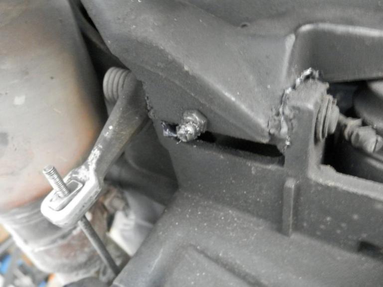

To save future problems, add a grease nipple and grease a couple of times a year. Easy job and greasing pushes out the crap and stops the entry of more crap and water.
Title: Re: Needle Roller bearing removal
Post by: KHilda86 on February 21, 2018, 11:59:33 AM
* Clutch grease nipple 2.jpg (41.2 kB . 768x576 - viewed 536 times)
Yeah that makes a lot of sense, you just drill through and tap a tread Martin yeah??
Thanks
Sent from my SM-G950F using Tapatalk
Post by: Martin on February 21, 2018, 12:24:53 PM
Remove the arm and drill and tap for a 6mm  or what ever size is your preference.  Be careful not to damage the clutch push rod boot, otherwise tears will ensue it is a pricey little item.
