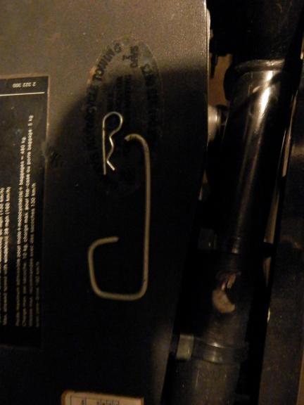

Got the Brick running today!  Wow did she smoke and normally I would have been worried but K100's do that,so I have read.  After sitting for 10 yrs boy did it smoke, windows open fans on, but the smoke did come to a end after a bit.
(https://farm5.staticflickr.com/4761/25672910947_fbfde4d634_k.jpg) (https://flic.kr/p/F7CnZD)Pump in jug to run bike (https://flic.kr/p/F7CnZD) by Tim Brown (https://www.flickr.com/photos/156697124@N02/), on Flickr
I was still not happy with the gas tank and how I am going to mount the pump in the tank, so I just bypassed the gas tank.  Ran the pump off a battery just to flush the fuel rail and all the other hoses, reg and anything I could have missed.  Slapped a inline fuel filter on the return line just in case.
(https://farm5.staticflickr.com/4632/25672908907_26ebb5ef03_k.jpg) (https://flic.kr/p/F7Cnot)Pump and fuel return (https://flic.kr/p/F7Cnot) by Tim Brown (https://www.flickr.com/photos/156697124@N02/), on Flickr
Did find out that there was no power going through the four wire connector.  Did a little looking and there was no 15A fuse that would normally power it.  Once I cleaned all the fuse and replaced the 15A missing fuse, everything worked great.  I think that my low fuel device is working too, it is up and open or down and shorted, so that should work.
(https://farm5.staticflickr.com/4752/40543970221_39b3c321c7_k.jpg) (https://flic.kr/p/24LJrPk)Bypass the gas tank (https://flic.kr/p/24LJrPk) by Tim Brown (https://www.flickr.com/photos/156697124@N02/), on Flickr

I replaced the "C" clips which are a bit of a pain with "R" clips. You can get them from hobby supply places. They are used to hold the body onto the chassis on RC cars. You need to drill a hole in the pin slightly larger than the "R" clip in the groove that takes the "C" clip. I have a bent bit of coat hanger wire with a small hook on one end and a finger loop on the other. As well as removing the seat "R" clips it will also remove the tank "C" clips. Your prop hinge will fit when you straighten it. The broken pin needs to be pulled from the seat mount and welded back onto the frame. A lot of the electrics need to be disconnected when welding.
* Seat Pin and Hook.jpg (22.77 kB . 432x576 - viewed 1719 times)

Worked on the seat a little yesterday, had to walk away from it.  It was just not lining up and so much of that hinge was miss off the frame, it will be hard to mock it up and weld it.  I will keep looking at it and come up with a plan.
The Final paper work from Wisconsin DMV came back today, now for the phone call to get the Bond on the bike.  Send all that in and get the "Bonded title" with the work bond in print on the title for five yrs.
From my reading, if I do this again (no title bike) I think I will try the Vermont registration method for the $35.  It seems the best way to do it even thought it just seem strange as I am unfamiliar with that process.

Post by: johnny on March 30, 2018, 09:18:44 AM
this is how i fixt that seat mount issue...
cleaned the paint off the frame... put a 1/4 bolt in the seat part of the hinge screwed into a long 1/4 all thread coupling... with seat in the down position... vice gripped the coupling to the frame... took off the whole shebang except the coupling and vice gripps... welded the coupling to the frame...
put it back together and now instead if that rod and clip... just screw the bolt into the coupling...
ride dangerously...

Post by: Timbox on March 31, 2018, 08:58:07 AM
That is great advice, I like the way you think....That seems to make good sense to me and should make things a little more user friendly.  Snow and sleet here, so it might be a good weekend to do that.

Post by: Timbox on April 05, 2018, 10:06:34 PM
Got the seat on today and finally got all the plastics back on her.  Now if we would just lose the 9" of snow we got that would be great.  Doing the fork oil next and then to find out when the front tire (new) keeps losing air.  I would guess the stem, but who knows....
Thanks again to Johnny for that seat fix idea, worked like a champ!
