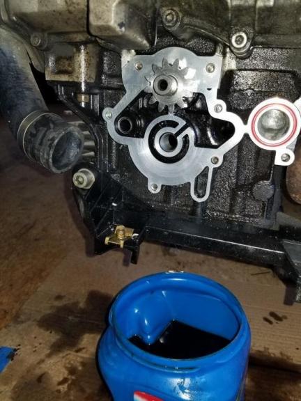

 Hey Yall I have a 1986 k75t with 35,000 miles as a Project Bike needing work, I installed a 2002 k1200Lt water pump on my Bike and No more Leaks,  My Question is There's no Small hole up top of the pump for the small Relief hole on the engine block,  is this Going to be A Problem down the Road????  Thanks for any info.

Post by: rbm on October 28, 2017, 11:59:50 AM
Shouldn't be a problem.  The pump design around that area changed in the later years; see the pic below:
(http://i31.servimg.com/u/f31/15/31/89/68/bmw_pu17.jpg)
Just make sure to keep that semi-circuilar hole on the engine block cleared by passing a wire through it to push out any accumulated gundge when the pump is off the block.  And make especially sure not to block that semi-circular hole with sealant when refitting the pump.

Post by: Gumbo on October 28, 2017, 12:19:42 PM
  Yes that's what I was talking about,  Thanks rbm I did make sure it was clear and not blocked... on the new pump there's nothing but flange surface so I put the Sealant as normal..
