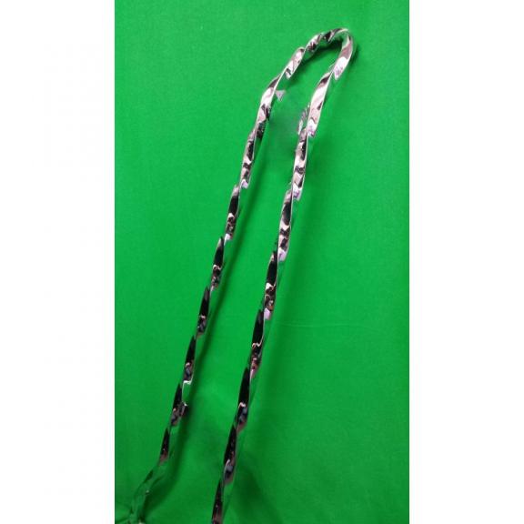

Post by: The Mighty Gryphon on February 02, 2020, 10:49:16 AM
Moderate ape hangers would probably work well on a K75s with highway pegs.
And a sissy bar!!!
* Twisted-HB---side.jpg (22.77 kB . 576x576 - viewed 1153 times)
