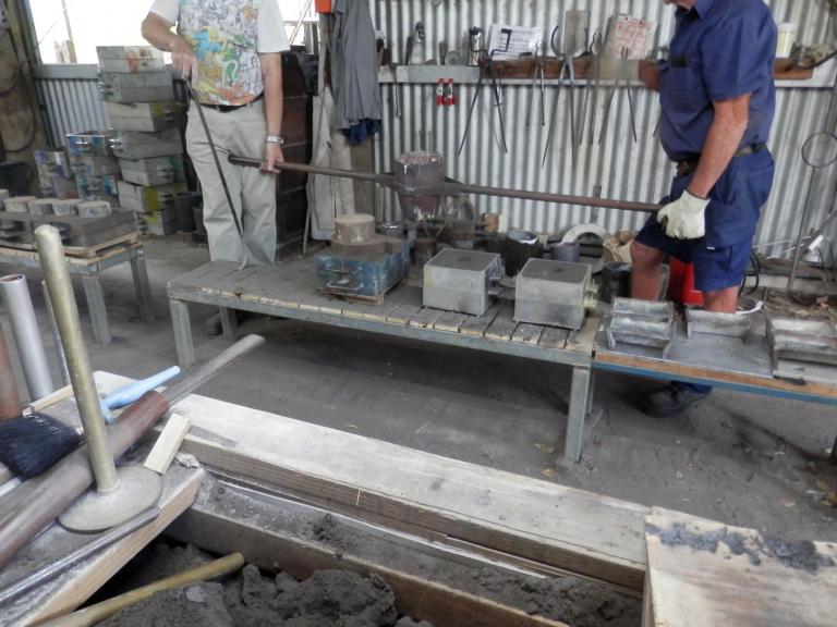

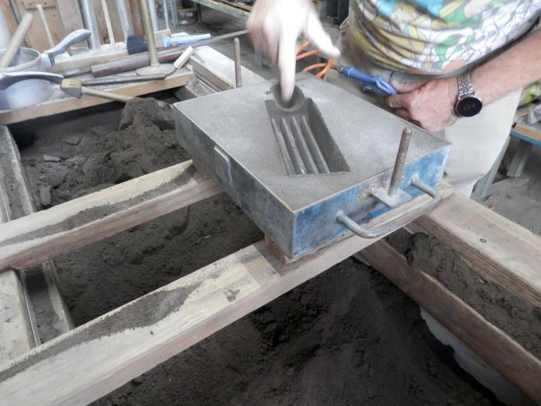

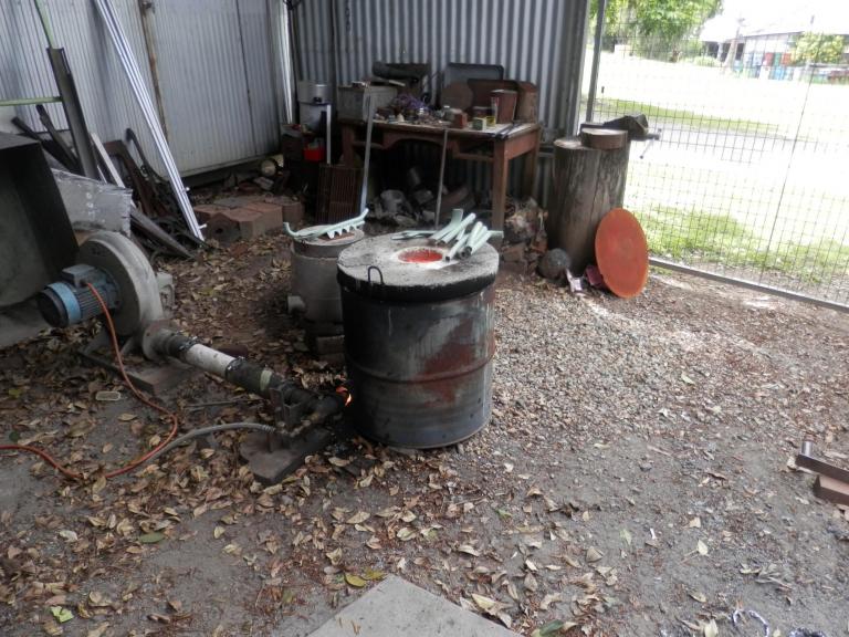

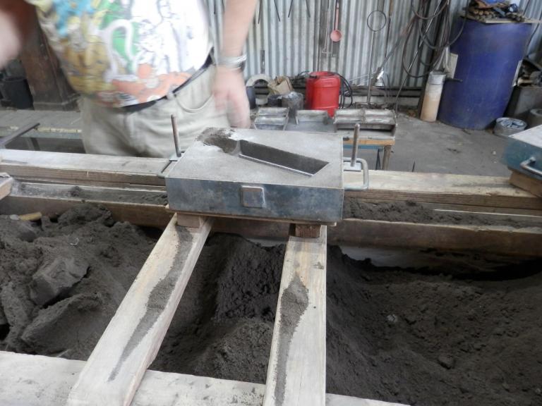

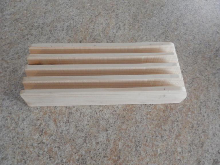

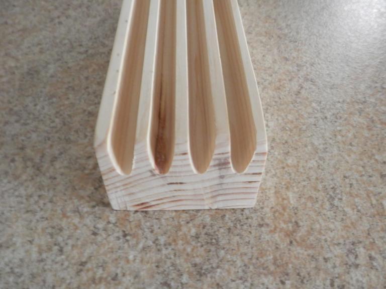

Post by: Martin on November 28, 2017, 02:17:30 AM
The men's shed were unable to make a wooden pattern that the casting plant would except. I ended up routing out a wooden pattern using my drill press with a cross slide vice. I tried a couple of different tools, breaking one with a 1/8 shaft. Ended up using a 1/4"cone shaped burr grinder bit, after a lot of minor problems. I have routed thin aluminium in it before, but only up to 5mm. I needed to route out to a depth of 15m,and due to the side thrust encountered the chuck kept on dropping out. When this happened the bit would wander, I tried belting it in with a lump of wood and a hammer, it would cut two grooves straight then would wander as the chuck dropped. I tried smaller multiple cuts no go.
 I tried the old talcum powder trick. but eventually solved it by lapping in the chuck with fine valve grinding paste. I thought every thing was fine used a new bit of wood. and managed to cut two or three grooves before it would skew off. the vice table was slowly pivoting under load. I had to put additional leverage onto the bolt that clamps the table and remove all traces of lubricant. I finally managed to route out all the grooves. Under the instructions I received from the casting plant I trimmed of both ends at a slight angle to aid removal of the pattern from the sand.
Last Sunday I dropped of the pattern for approval, and was told to come back on Tuesday if I wanted to see the process. I brought The Ministers camera and took a heap of pictures of the process which I have been unable to shrink with Picresize. I will post at a later date when I can shrink them. The whole process didn't take long, about 45min. They use a different mix of aluminium for different castings, alloy heads pistons and other things depending on requirements. After they broke it out of the sand It was looking good, it will require a bit of a clean up but very true to the original less than 1mm difference. I will start on the clean up and drilling the galleries this week.
Really good guys at the plant I had a good look around this time. There are three sections woodwork, metalwork and the casting plant all run by retirees. While the casting was cooling I was invited into the machine shop. Heaps of equipment, I was in heaven they have two metal lathes a turret mill a small CNC router, and the guy showing me around has a 3D printer and is willing to do projects for members. He had a look at the wood pattern and said he could of saved me a lot of work and run it up in the mill and done it in two pieces and routed out the galleries. He trains guys on how to use it all. I will join in seven months time when I finally fully retire.  The yearly cost is a paltry $30.00 Au annually.

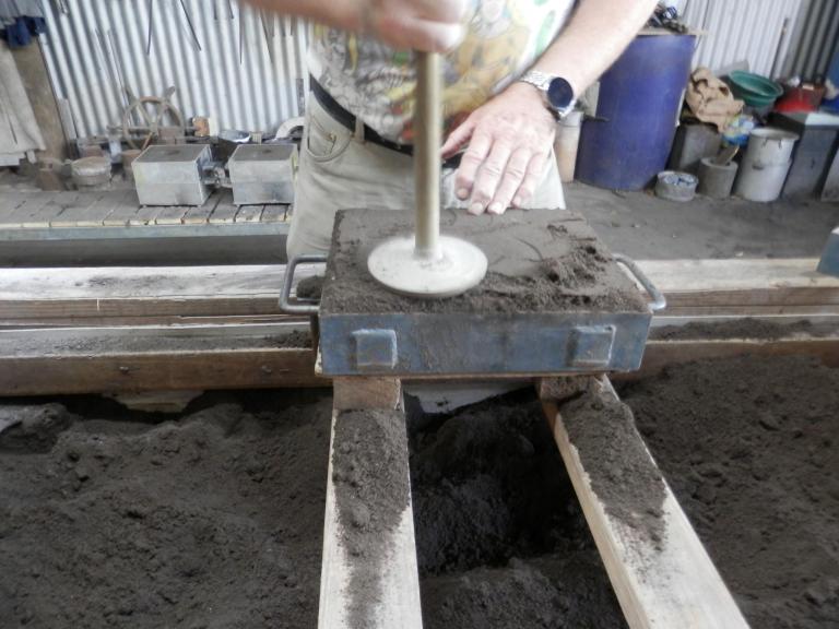

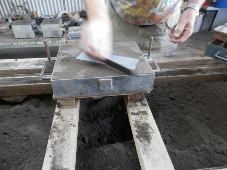

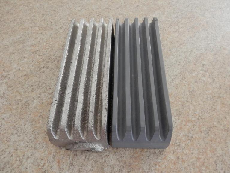

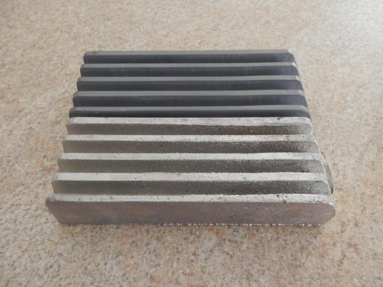

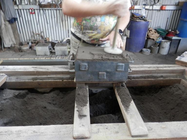

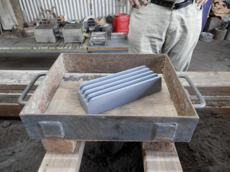

I found the dark corner, pictures of the casting process.
* Fuel Cooler Pattern 1.jpg (56.18 kB . 768x576 - viewed 957 times)
* Fuel Cooler Pattern 2.jpg (50.11 kB . 768x576 - viewed 935 times)
* Fuel Cooler Casting Furnace .jpg (93.32 kB . 768x576 - viewed 887 times)
* Fuel Cooler Casting 1.jpg (64 kB . 768x576 - viewed 892 times)
* Fuel Cooler Casting 2.jpg (63.8 kB . 768x576 - viewed 954 times)
* Fuel Cooler Casting 3.jpg (62.71 kB . 768x576 - viewed 869 times)
* Fuel Cooler Casting 4.jpg (61.95 kB . 768x576 - viewed 902 times)
* Fuel Cooler Casting 5.jpg (63.13 kB . 768x576 - viewed 949 times)
* Fuel Cooler Casting 6.jpg (64.16 kB . 768x576 - viewed 921 times)

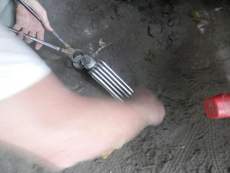

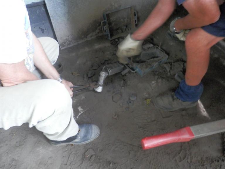

Title: Re: K75 Fuel Cooler
Post by: Martin on November 28, 2017, 04:50:22 PM
I'll start the process off cleaning and drilling the galleries on Friday. I was going to use a bridge and a couple of Banjo bolts to connect a couple of the galleries. But have now decided to mill a recessed cross bridge on the back and have a cover plate welded in. I just have to find someone with a TIG.
* Fuel Cooler Casting Pour .jpg (70.35 kB . 768x576 - viewed 907 times)
* Fuel Cooler Casting Cleaning 1 .jpg (40.57 kB . 768x576 - viewed 815 times)
* Fuel Cooler Casting Cleaning 2 .jpg (43.17 kB . 768x576 - viewed 840 times)
* Fuel Cooler New Casting 1 .jpg (61.55 kB . 768x576 - viewed 887 times)
* Fuel Cooler New Casting 2 .jpg (59.53 kB . 768x576 - viewed 881 times)

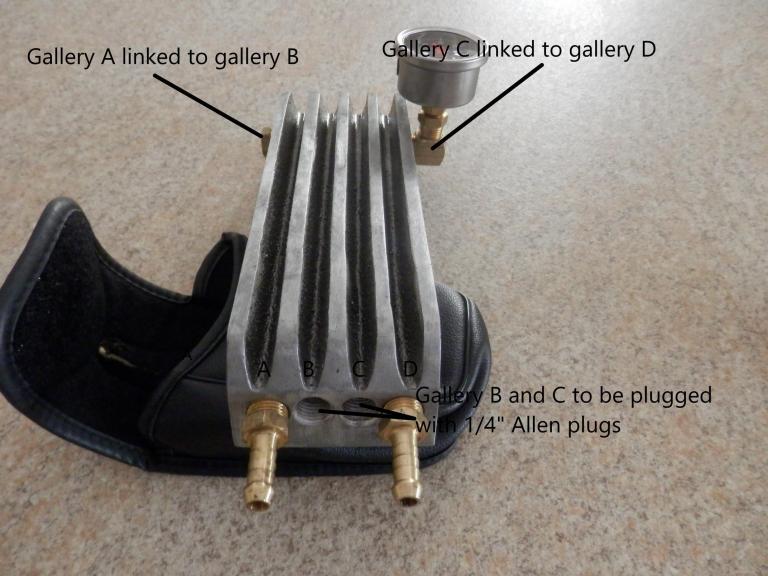

Post by: Martin on December 02, 2017, 01:54:49 AM

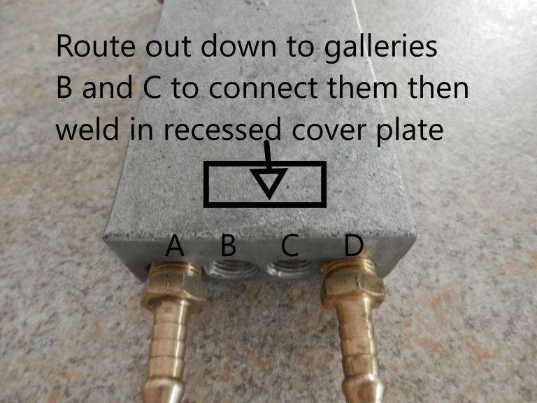

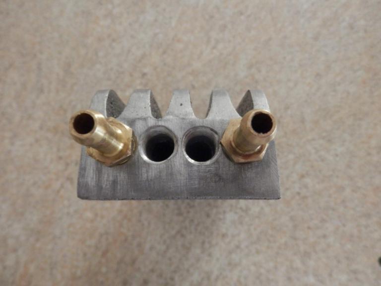

Getting there slowly all the galleries drilled and tapped bar one. Went to a couple of places chasing 1/4" BSPT Allen plugs, all that I could find were hex plugs which I could use if I wanted to make them non removable. I'll wait till Monday and try a few more places, if I can't get them I'll order them of Aliexpress. I had a gauge and a couple of fitting that I could substitute for one of the plugs. Not sure whether to go that route. I am also not sure about painting it. I was going to hit it with a coarse sand blast then paint it black and polish the end of the fins. Still trying to find someone to weld on the back cover plate which I will recess into the back of the cooler so that once welded it will be flush.
* Fuel Cooler Galleries 1.jpg (58.52 kB . 768x576 - viewed 809 times)
* Fuel Cooler Galleries 2.jpg (34.79 kB . 768x576 - viewed 803 times)
Post by: Martin on December 02, 2017, 04:55:22 AM
* Fuel Cooler Galleries 5.jpg (63.68 kB . 768x576 - viewed 763 times)
* Fuel Cooler Galleries 3.jpg (61.65 kB . 768x576 - viewed 751 times)

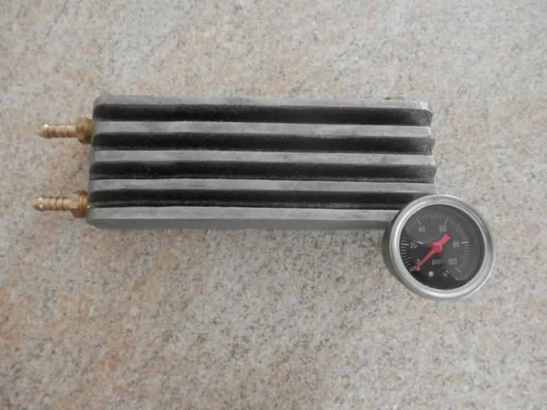

Post by: Martin on December 04, 2017, 12:02:23 AM
Spent 2.5 hours chasing bits, the third place I tried had six only of the Allen plugs.  :clap:The rest of the time I zig zagged back in the direction of home chasing Teflon paste I eventually got it at the local Super Cheap the closest car place to home. I had tried six places before I struck gold. I proceeded to fit it out and I am reasonably happy with it. But when I went to make the brackets and found I had no aluminium flat bar. I had had enough of chasing around in the morning and also had to take the Honorable Minister to the Doctors ( Nothing serious). So I will have to chase some flat bar tomorrow. However I had some double side tape so I stuck it on roughly in the position it will occupy give or take an inch. It does sort of stand out a bit more than I anticipated so a paint job including the end of the fins might be called for.
Post by: CNRED on December 04, 2017, 07:26:51 AM
Your fuel cooler looks pretty sanitary.. If the gauge was not there I doubt it would catch the eye of anyone not familiar with the bike.  It blends in almost perfectly, excellent work!!
Post by: The Mighty Gryphon on December 04, 2017, 08:53:52 AM
Wow, that looks good!
Post by: Filmcamera on December 04, 2017, 10:43:34 AM
Looks great!
Post by: Martin on December 04, 2017, 01:02:52 PM
Thanks fellas, the gauge is only there probably until I get a pressure reading on the return line. I am also one Allen plug short, I did a slight booboo that required me use 6 instead of 5. The place I got them from has one left, which I will snap up today. I'm also interested to know what the pressure is and will it show up problems with the FPR.  :dunno
Not entirely happy with the fin spacing, the original pattern was made with the cooler fin spacing mimicking the valve cover. However due to the restrictions imposed by the sandcasting process, and the use of my drill press with a burr grinder bit as a mill required thicker fins. However I have learned a lot and if I decide to do a Mark 2 version now with access to a turret mill and a CNC router who knows what can be achieved. I have know learned how to join parallel galleries without resorting to welding. I am going over to get some stainless flat off my mate for the brackets, I was going to use aluminium but he has talked me into stainless.  :nono
I have also decided to give a coat of satin black and leave the fins polished. I think painting it  will allow it to blend in a bit better. I might even paint the end of the fins, if I don't like it I can always buff of the paint. I know unpainted aluminium disperses heat better but from what I can find out there is only a slight difference between the two. :2thumbup:

Refitted the newly painted cooler. And I encountered a slight side effect from fitting it. When the fuel level drops, but not low enough to activate the low fuel light the pump starts to scream like a banshee. I removed the filler cap and had a look, the bottom half of the pump was fully submerged. I was wondering whether the pump had picked up something? It has got a fully intact OEM screen. I decided the first thing was to eliminate the cooler as a problem so I removed it first. As soon as it was removed the noise disappeared. :dunno As the temperature in my garage is about 30 C I has decided to ruminate on the matter and leave it for another day. I suppose I could refit it and use the screaming as a warning for the fuel light about to come on. :hehehe
Post by: Laitch on December 30, 2017, 02:41:08 AM
As soon as it was removed the noise disappeared. :dunno as a warning for the fuel light about to come on. :hehehe
I think turbulence within the cooler is restricting fuel flow. The fuel path might be too angular. Otherwise, I think it's signalling profiterole and Cuban coffee time.
 :yippee:

I'd like to understand the interior fuel path of the cooler. If the fuel must move through hard ,right-angle bends or whether there are curves to its path.
