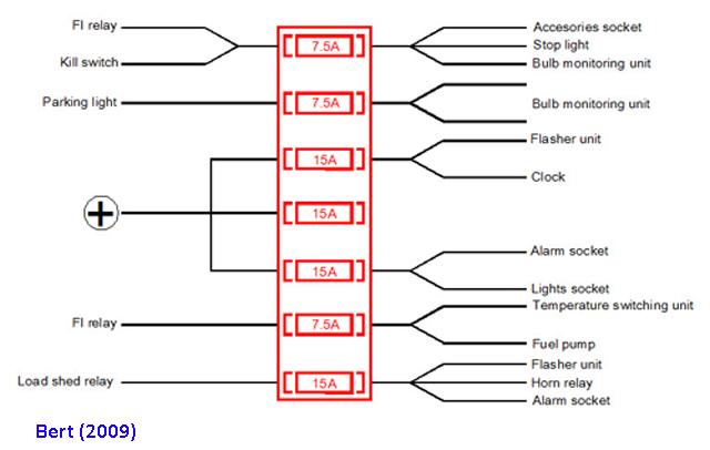

Dumb question, which is Fuse #1 ??  Are the positions labeled from the top down or bottom up ??  I've looked (apparently not well enough) and can't find how the fuse positions are numbered.
 Thanks for the info, I'll get out my multimeter and start checking. The voltage on the green/black wire was NOT 10-12 volts, which I thought was odd at the time, now I know for certain. The weird behavior of the tach made me think it was the ignition switch, but no go. The kill switch is in the "enable" position (straight up) for everything I've mentioned.

Post by: Laitch on September 09, 2017, 08:05:59 PM
Before you're driven into a paroxysm of confusion, duddini, the arrows indicate pinch points for cover removal.
(http://www.motobrick.com/gallery/0/1601-090917200459.png)
