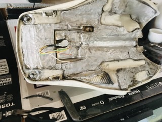

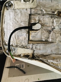

Post by: Skunky on August 26, 2017, 06:52:59 PM
 On Monday my back had some sort of seizure reducing me to crawling around the house and not moving much. Not being good at inactivity I decided it would be the perfect time to make my seat. I have already made a seat pan using a rear from a RS as Sloping rear on the LT felt a bit clumsy.
(https://uploads.tapatalk-cdn.com/20170826/6cb6c716eebaa27508c82987c3997536.jpg)
The unit was cracked and therefore a reasonable price £15 .
So after cutting and painting I have built the new seat base.
(https://uploads.tapatalk-cdn.com/20170826/49cd6c318d7b92890d4beb0614dc332b.jpg)
(https://uploads.tapatalk-cdn.com/20170826/a6b7dfeb7c1a81ce4bf3907ae19507f1.jpg)
The lights and indicators are an led strip that will sit on the black line. (https://uploads.tapatalk-cdn.com/20170826/66dc2648de108159d802dc4cc28af548.jpg)
Anyway I had bought a used leather jacket  and turned this
(https://uploads.tapatalk-cdn.com/20170826/163dbdbe77183d6f78e4490d82ac558c.jpg)
Into this
(https://uploads.tapatalk-cdn.com/20170826/1ddee4adbfa26f86c0f22964cd9083b7.jpg)
I'm pleased with the outcome and know it will look better when stretched over the base rather than loose. Almost worth the back pain.

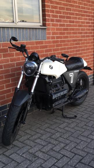

Nice work, Skunky! Digging the polishing. Are those the black emblems? They look cool!

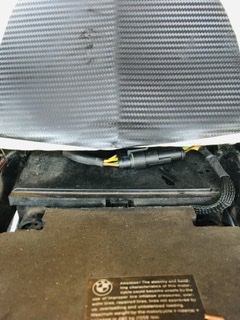

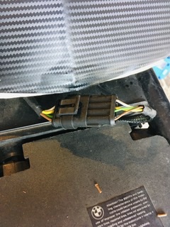

So I need to go through everything and find out why. Checked the plugs and I'm getting a spark. seems to be a little fuel on the plugs but nor sure if there is enough or not. It could also be that there is not a full charge on the battery, I understand that they can be a little temperamental. So Overnight charge and give it another try in the morning. Failing that I will leave it until Wednesday and look at the fuelling.
Title: Re: Not a cafe racer project K100
Post by: Laitch on May 31, 2018, 05:59:41 PM
 :popcorm
Post by: Martin on May 31, 2018, 07:04:30 PM
Four pin plug under the right hand side of the petrol tank.

Thanks Martin. I assume your talking about the fuel tank plug. I have already checked that. And cleaned all contacts. I didn't have time to delve too deeply as I was going away for a few days to celebrate my Dad's 84th birthday and visit my little Grand Monkey. Anyway fuel pump was working and I have fuel at the rail but not spitting out of the injectors. A quick check shows I have no voltages showing on the controller pins so that's where I will be going next. Probably due to the after market speedo installation. All the fuses are intact. I shall work through the wiring with Mr Haynes and sort it out tomorrow.

I armed myself with everything I needed to solve the starting issue. Multimeter, Electrical diagrams, De-oxit, Vogels non starting guide on my Laptop, Oil, Syringe, Patience and of course Cider.
Stage 1 - I opened cleaned and resealed all electrical sensors under the tank. Again!  :dunno
Stage 2 - Remove spark plugs, cleaned and checked the gaps. Then put a small squirt of oil in each cylinder to improve compression and smoke out the street  :nono. Put on the petrol tank and start..........................Still nothing  :dunno
Stage 3 - Start running through the Electrical system and Vogels check list. Injector and Temp sensor resistances were OK. Checked the FI relay had +12v and that +12v was reaching pin 9 on the ECU plug (and therefore the injectors) all good.
I then started on the negative pulsing from the by putting a 12v led between pin 9+ and pin 12 with the ecu plugged in and had no light up. I started to check the feed to the hall sensors and Airflow meter and when I was turning over the check to voltage I had a single pop ignition and a flash on the led. Bearing in mind the fuel tank was off at this time.
I refitted the tank and she started :clap: :clap: Smoke billowing down the street and very lumpy.
I let it run to burn off most of the oil and then removed and cleaned the plugs again. This time it started smooth as you like. :clap: :clap: :clap: :clap: :clap:
I would like to have found a definite fault but it appears the bike was just being reluctant.

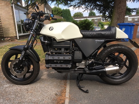

Well done, Gary! Got a finished photo shoot?

Very nice looking bike! Congratulations and enjoy riding, it actually looks comfortable...

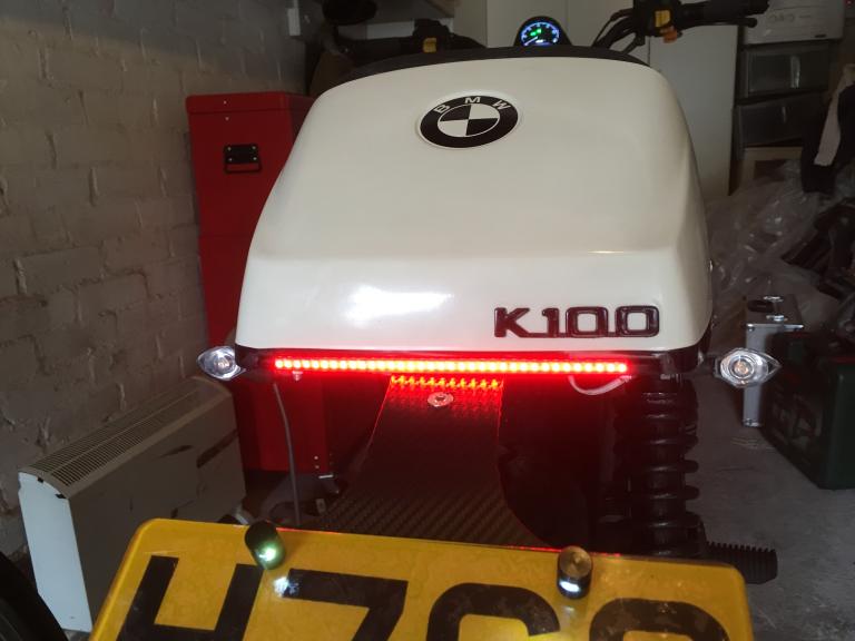

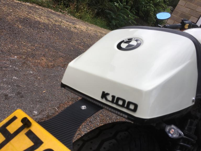

Spent the last few days finishing off the Machine and then took it for its MOT. The garage where I go are very accommodating and looked her over before the test and advised me of the following.
Under new legislation the indicators on a motorcycle over 50cc need to be more than 240mm apart at the rear and more than 300mm apart at the front. When you consider that a 7 inch headlight is only 177mm wide that means that unless your Bike has long stalks it could fail an MOT. The tester told me that most bikes already fail this requirement!
Anyway I need to add extra indicators to the rear, he will let the front go through. New indicators ordered.
Also the rear brakes were binding. I had bought new pads and the inside pad seems to be dragging. When I looked closely it seems that the rear calliper does not sit centrally over the disc. There was not any shim fitted when I took the disc off for cleaning and I could not see any on my Haynes manual. I ended up sanding down the inside disc and it's moving freely now.
I need to play with the bike a bit. Its running a little lumpy and I'm getting popping and the occasional backfire. Wakes up the pedestrians  :hehehe. The bike starts on the button and idles ok. Does not need the choke either. I think I may need to look at the air mixture or possibly ignition timing. If I get no joy I will post a video.

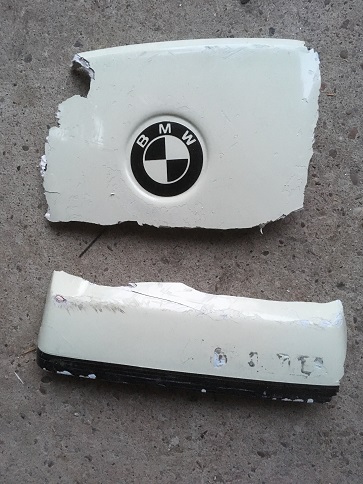

Brotherhood of the Beemer hear my confession. Insanity! Distraction! or Just Early Stage dementia I am not sure......
Last Sunday I took off the rear tail piece,(which I had so lovingly created using a broken tail from an RS instead of the slightly clumsier tail from the LT), In order to fit some additional Indicators to satisfy the MOT gods. Fitted the indicators and later that evening went for a short run down a fast dual carriageway for a "check everything was OK" joy ride. Got back home minus the tail!!!!
Went back out and recovered it.
And this.......
* rear1.jpg (68.71 kB . 378x504 - viewed 1333 times)
Became this.........
* rearohdear.jpg (73.94 kB . 363x484 - viewed 1405 times)
To say that I was pissed off would be an understatement. But it was me that put the tailpiece back on, and me that didn't put the screws back in. Oh and me that has to bear the bits falling off criticism and the "what else haven't you done up" Jibes from her in doors.

Finished the last bits and pieces.

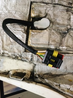

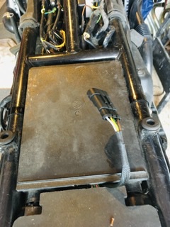

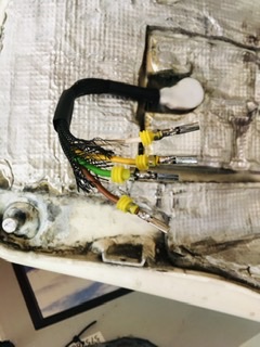

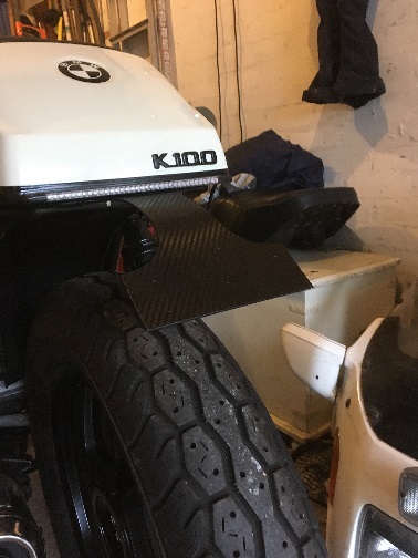

Made new brackets and fitted the new Tailpiece MK3 with the light strip sunk into the tail. Looks much better I think. I also used rubber well nuts and allen bolts for a better looking and stronger fit.
* file-26.jpeg (69.36 kB . 768x576 - viewed 1529 times)
* file-28.jpeg (39.94 kB . 768x576 - viewed 1546 times)
Fitted the replacement Side Stand. Or as DJewen called it the Suicide stand. What a mad idea a stand that springs back up and is impossible to put down while sitting on the bike. I find if you get off, put it down with your boot you can lower the bike onto it. Never seen one like this before though  :dunno.
Finally Calibrated the speedo. I took the bike out with a GPS program on my mobile phone and it was within 2 MPH. GPS show 40 Speedo said 38 No changes required.  The cheapo Chinese speedo works great. The indicator lights are clear and bright and its accurate. I can say first impressions are that it was a bargain at £21.00 Sterling. I will update on its long term reliability.

Hey People. Just thought I would share the cost of my Build. Being Anal I kept a spread sheet.
I think it was a bargain. Still going great and still turning heads   :clap:

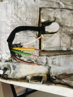

Post by: Skunky on March 29, 2020, 04:12:14 AM
Small side project. Replace the annoying and let’s face it, notoriously unreliable 4 way connector to the fuel tank and put it in a more accessible location so that I don’t have to remove the sides to get the tank off
Post by: volador on March 29, 2020, 07:09:14 AM
Nice work. Just an observation looks like green and yellow are reversed
Post by: Skunky on March 29, 2020, 07:25:42 AM
No they are the right way round. Bike starts runs and roars  112350

Those switches look nice and clean. Are they made by MotoGadget?
Post by: Skunky on April 05, 2020, 02:52:06 PM
In Answer to Milq and another question asked by sr20clubbie
The switches are not Motogadget just ones from ebay. I wanted to reduce the size of the cables as I was running it through the handlebars. I also decided to only have switched negative reducing the chances of shorts in the switches and lowering the voltages so I used a 4 way relay board and switch the starter, high/low beam and cutout switch through that. I also fitted a changeover relay for the cutout as the cutout switch is momentary. I wanted to keep the BMW flasher unit as I like the auto cutout function as I'm lazy and have been known to leave my indicators on.
The Choke lever is from a Motoguzzi V11. i used all the existing BMW cables but had to make new cable end on the choke. It all works great.

Post by: Skunky on April 19, 2020, 07:52:13 AM
Due to the Pandemic I seem to have a lot more time on my hands lately, So after completing the Handlebar Switches I started looking at what else I can improve.
When I finished the bike in 2017 the mechanic at the MOT centre did not like the rear strip light because when the brake lights are on the integral indicators do not show up. So to make him happy (and keep me safer because he was right) I fitted a pair of mini indicators either side of the rear tail unit. Problem solved.
So why does it still piss me off!. Even after recently fitting bar end indicators I scoured flea bay until I found a light strip where the supplier claims the indicator sections are still visible when the brake light is on and ordered it.
Although slightly thicker meaning I had to make a subtle adjustment to the rear tail piece it actually works. I have taken photos of the old and new lights strips but because of the glare it doesn't look that different in the photos. So heres two pictures that look almost the same  :laughing4-giggles:

Just another add on. I decided to try a keyless ignition system on the bike so thought I would get one of the Chinese PKE units that you just walk up to the bike and it turns the ignition on. Just to save the effort of messing around with keys. After a two and a half week wait the goods arrived. Unfortunately without the PKE ariel so basically I was ripped off  177381.
Anyway it cost peanuts to by so I shrugged my shoulders and fitted it anyway. Lo and behold it works  4265249878. Its programmable and as I don't like unnecessary noise when I set off for work at 5.00am (The bike is noisy enough  :laughing1:) I have programmed it for stealth mode.
Please see video below

* BMW2022.jpg (55.72 kB . 576x576 - viewed 750 times)
Hi Motobrickers,
I can't believe its been four years since I finished my build, as you can see the bike is still going great and we (me and my beemer) took part in the Distinguished Gentleman's Rideout here in Derbyshire. I can't stress how much I love this bike and how much I learnt from this site, which I regularly pass on to other builders and owners on the Facebook K groups that I belong to.
These are really great bikes and I had the only BMW K out of 200 bikes. There were a few R100's but they are as common as muck these days.
