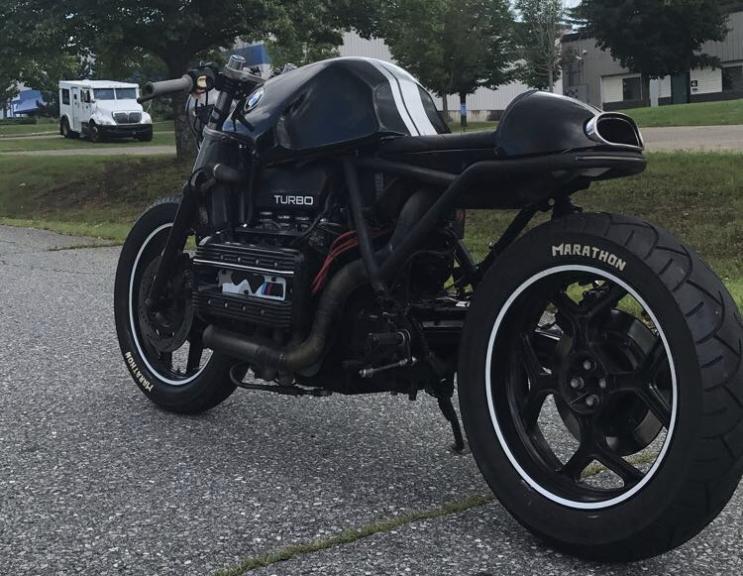

Photo of the finished aesthetic product minus the mirror. It's actually broken down with the issue when
* IMG_2342.jpg (76.72 kB . 743x576 - viewed 881 times)
I took this photo :falldown:
