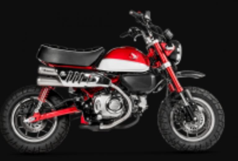

Post by: johnny on November 04, 2019, 03:34:19 PM
why didnt you say so...
maybe getts a new honda monkey or stop whacking hoes...
* Screenshot_20191104-143817.jpg (31.27 kB . 768x521 - viewed 577 times)

Post by: Laitch on November 04, 2019, 03:54:41 PM
maybe getts a new honda monkey . . .
It's got a USD fork! All that's needed is an Acewell, BEP and strap-ons.
