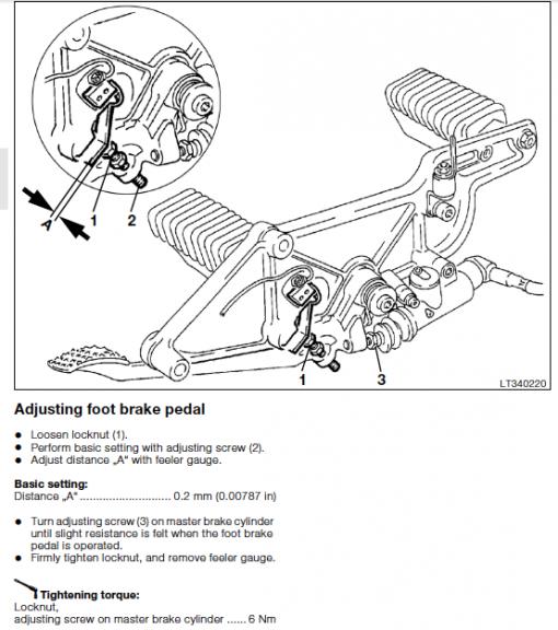

The attached diagram shows the correct freeplay spec for adjusting the brake pedal. This is from the BMW K1100 service manual available in the Repair Guidance section's Master List here on the site. It also contains other adjustment specs necessary for the safe and efficient operation of your bike.

Thanks for the replies - I had seen that diagram previously Laitch and the screw I adjusted after fitting the new pads recently was the one which is numbered 3 in the diagram and I also bled out enough fluid so that all the old fluid was expelled and checked that the caliper pistons were moving freely.

Laitch and Martin already addressed free-play, new parts will remove free-gaps between them after reassembly. Tightening the adjusters to "bite" with minimal pedal movement was your undoing.  Due to wear and corrosion the tolerance stack-up between parts can change after reassembly.
