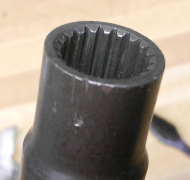

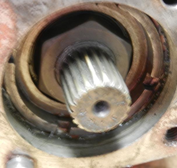

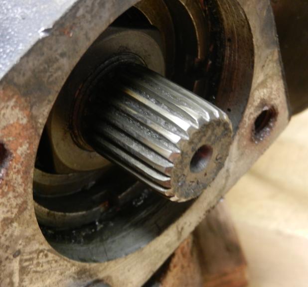

The bike has enough mileage that the rear splines could be worn through poor maintenance.  The condition of the bike as a whole might tell how it was cared for, or maybe not.  If you are not sure, you might offer the seller a non-refundable cash deposit to be applied to the price of the bike to inspect the drive shaft splines.  The understanding is that if they are in good condition you will purchase the bike.  If not, the seller can keep the cash as payment for opening up the swing arm to inspect the drive shaft.
This is probably the most important part of the bike's inspection since worn splines can be the most costly repair to be made on a used bike.  Below are a couple photos of what good splines look like on a bike with 90,000 miles.  Note how wide and flat the tops of the splines are.  As they wear, the tops will get narrower until the entire spline is gone.

Normally, it is only the splines at the final drive end of the drive shaft that wear.  At the connection to the transmission, the splines are stationary, and as a result, there is very little wear, if any.

Don't worry about the final drive input splines. The drive shaft splines are softer and wear first.
